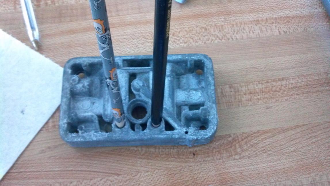

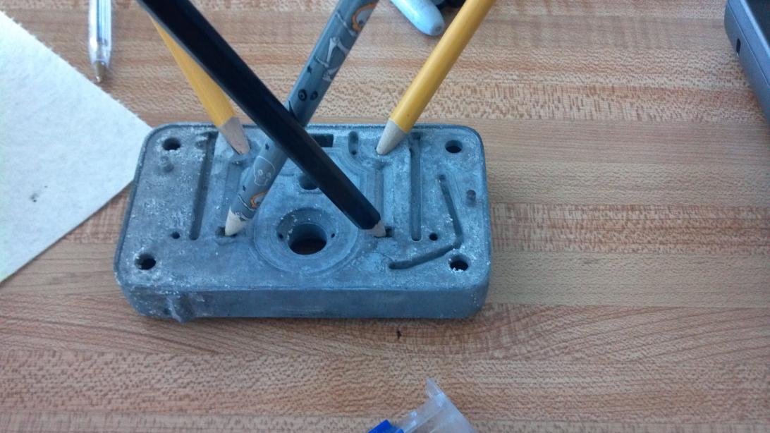

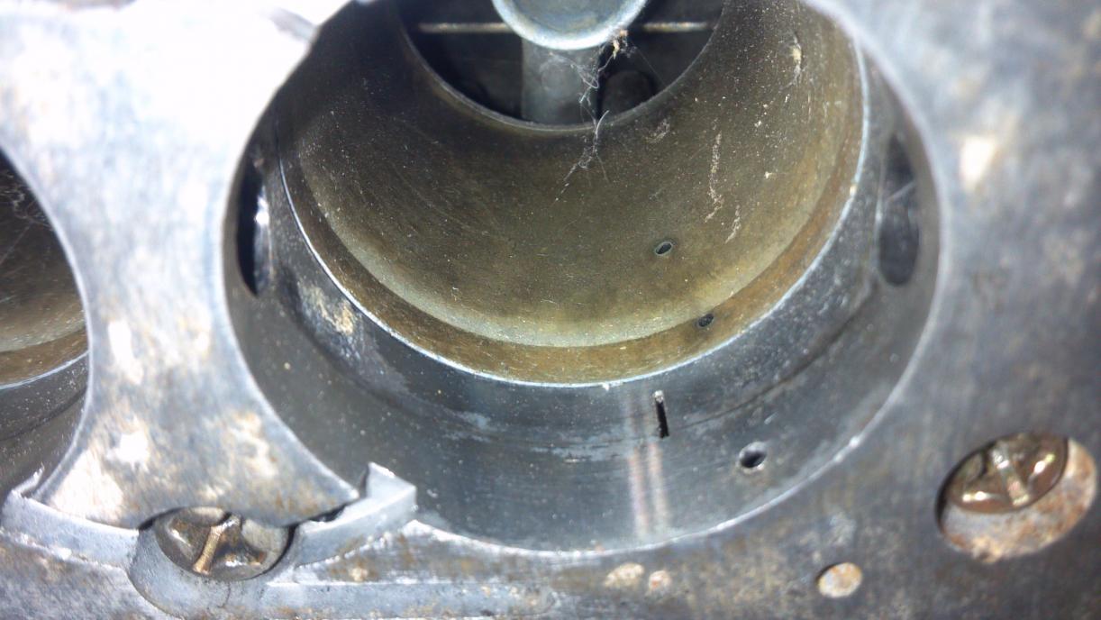

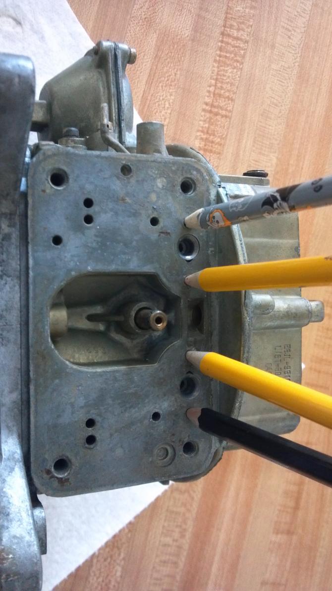

Looking down the carb when I punch it shows a nice solid spray of gas. Any thoughts? There isn't a lot to adjust on these holley carbs. The two mixture screws which I took to best lean idle and what I think is called the accelerator pump, which is the spring loaded adjustment bolt that you tighten or loosen. (Not the idle screw). It didn't seem to change anything when I adjusted it. It was as loose at it would go upon arrival and I tightened it to the point where the spring was almost fully compressed at idle and it didn't change the bogging. Has nice smooth idle at 900 rpm and no problem from 3000 on up.
