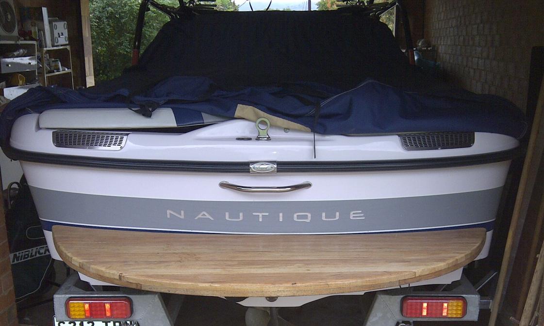

    I have just purchased a new composite platform for my 2003 216. I am going to take mounting brackets of my teak one and mount them on the composite platform. I am hoping for a little guidance re drilling and fitting the new platform.
    Does anyone have any tips re the best method of ensuring that I get the brackets lined up properly and drill my holes in the correct spots? What is the simplest method to do this?

    I would use the teak platform and make a template. Second idea is to put the brackets on the boat, then rest the new platform on them and mark the holes.
      That first idea is just asking for trouble. Go with the second one. Get the brackets installed on the boat and center them in their mate. Set the new platform down on them and match drill one, then install the screws. Then match drill the second bracket.
        +1...this is how I did it when ditching my teak step and I had no problems. I would leave the screw slightly loose and tighten them all up once all the screws are installed.
        On a side note, I have been thinking about switching my poorly designed 03 brackets with the new 2012 step brackets that allow you to remove or just fold down. I don't know how much it would cost or if it's even possible.

          Shooter: did you just use the old screws from the teak platform? Are you happy with the change to the composite platform?

            I did get new screws because the composite step already had screw holes and I tried to use some of the existing holes. My teak screws were one size too small and I picked up some larger new stainless screws from West Marine. FYI..The step is metal reinforced where the brackets attach underneath. You will probably need to mark the step then drill the pilot holes on the ground to get the leverage u need.

                Just wanted to say thanks for advice, happy with change from teak to composite, i love the look and colors match boat really well. Thanks again.
