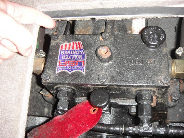

                      Here are a few pictures of the vdrive unit, the one on the left shows my finger pointed at the location of the plug on the backside that you can't see, if you feel for it your locate it. The second picture has a red square drawn around the drain plug in the front, its a pain to unscrew since there is so little clearance, a ratcheting box wrench is helpful. Given the angle it sits at, most of the water comes out the back plug, so if you miss the front one its probably not a big deal, especially if you cycle AF through the system after draining.

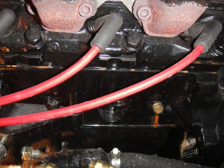

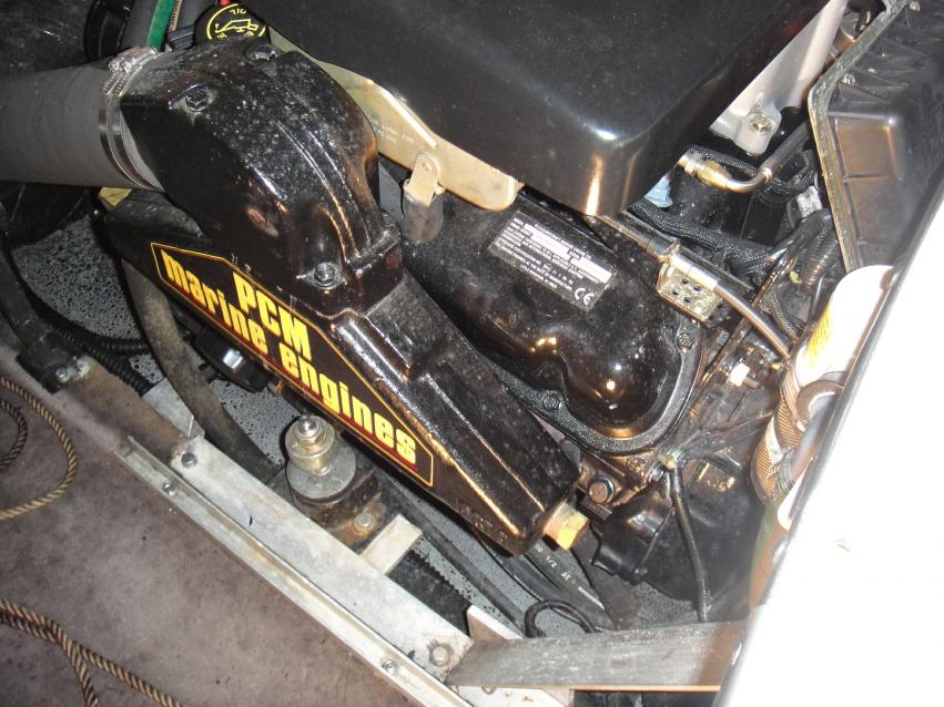

                        Here are 3 pictures taken on the starboard side of the engine block, notice the larget brass plug in the exhaust manifold, the small brass plug on the left end of the transmission cooler - which is actually painted black but in my case some of the paint has worn off from using a box wrench on it, and the brass drain plug on the block - notice the orange rust streak under it. On the transmission cooler I disconnect the hoses from it to drain the water out of the lines in addition to the plug.

                          Beautiful, thanks for the pic of the V Drive... the oil drain is under the one you're pointing at, right? I pulled the plug you're pointing at, and removed one of the hoses...assuming that's enough, but I'll pull that other plug just to see if it's necessary.
