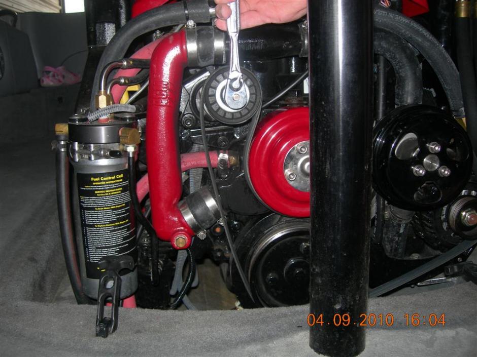

        I think he means the u-tube "similar" to the one shown in this pic. There is a plug at the bottom.

          Pic is perfect, the brass plug at the bottom is what I was referring to. You can also see both heater lines in that pic, I only remove the upper one. Note, you want to remove ALL plugs, drain everything including the heater core, then re-install ALL plugs.
          Did mention earlier draining/changing the fuel filter. Tools pic shows the Fuel Control Cell (black canister), there is a brass plug on the underside to drain any water, and replace the filter & o-ring(s) on the inside unless you are certain it is new or not beyond it's service life.
          If you need an assist with removing the impeller, Tool did a very nice Tutorial in a thread on that!!
          PS, when re-installing, use teflon tape or paste on the various brass plugs but NOT the knock sensor.
