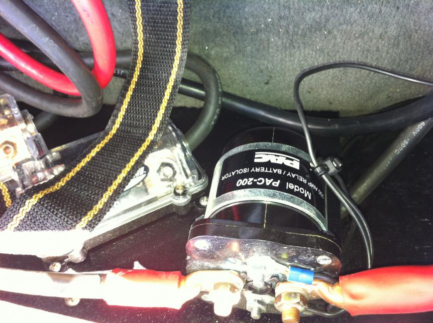

                          What exactly do you have (i.e., what isolator do you have)?

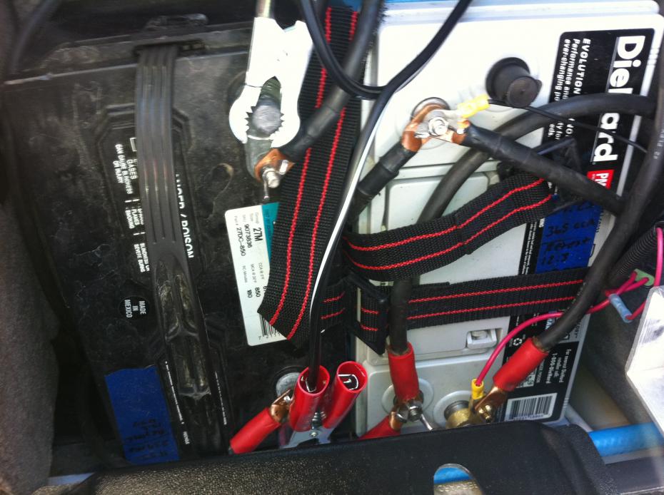

                            Im going to try and download some pictures to make it easier to advise me.

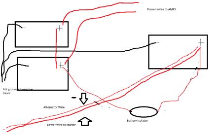

                              Here is a picture I drew of my wiring diagram its not the best but I think it will work.
