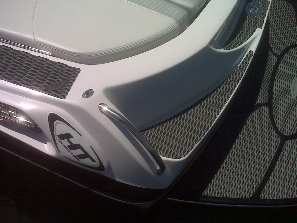

I do product development for Hydro-Turf Traction and just re decked my 09 210 SAN.
Feel free to email me if you need some more info on this product.dave@hydroturf.com

Dave love your product (have it on my 2010 Yamaha SHO) but I want to keep the boat factory and uniform. I would have to replace all the sano and theres ALOT. Plus I dont want to have to cut it, if I buy new I want pre-cut.2008 210 SAN TE (Moonraker Yellow over Midnight Blue)
already have all the diework(tooling) done for this model so it would coma as a completed kit,precut and ready for installation product.
let me know if you need additional images and it's avalible in any of the HT colors (www.hydroturf.com)
