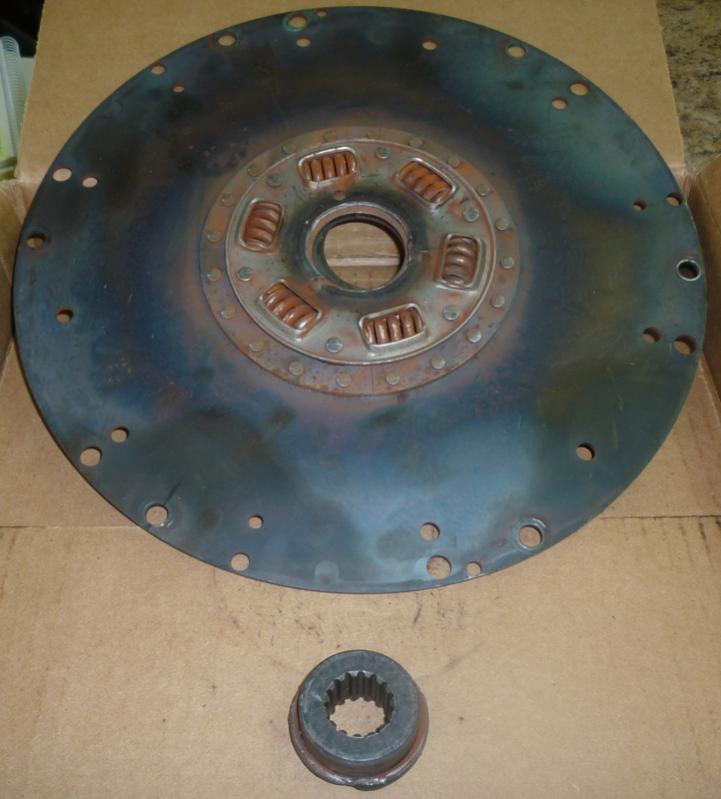

                This is the damper plate that failed causing my transmission problems and subsequently very long swim. You can see where the weld broke.
                Chad

                  One tack? Thats it? Coming from a welder / fitter / machinist ... that would never hold. Even if the centre piece was press fit I would have at least put three good size tacks on it.
                  Can it be fit up and re-welded?

                    re-welded? NO, you throw it away and put a new one in. I can only imagine where these parts are being sourced these days.

                      Its not like alignment would be difficult to attain if you know what you're doing.
