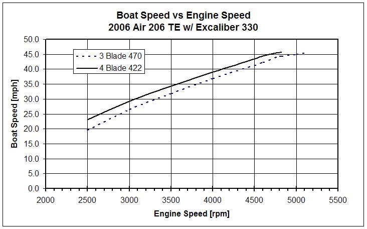

My first thought would be a badly damaged or totally incorrect prop.Please do not PM me directly asking for advice on how to repair your boat. While I would love to help everyone, I simply do not have time to respond to all of the inquiries. Please post your questions on the forum, so that all of our members have a chance to answer.
Could it possibly be an issue with the signal in the DBW system? Do you notice any excessive vibration? That's the first sign I've noticed of a damaged prop. Jeff makes a good point, it could be the wrong prop all together - which a dealer might not notice under inspection.'08 196LE (previous)

PCM Issued an update on CAM retard for these boats and I re tuned mine using laptop , now the thing flies past 40mph and feels much more power and hole shot, just a thought
I wonder if you're getting the real story on the dealer service? There's no way a Nautique dealer wouldn't realize instantly that there is an issue here. That boat rips out of the hole, and is easily mid 40's WOT.Originally posted by toyota40runner View Postmy friend has a 2007 206 with the exc343. something has to be wrong with the throttle servo or something because the hole shot on this boat is lame and it tops out at 36 mph. supposedly the nautique dealership looked at it a couple years ago and said there was nothing they could do. anybody heard of this problem?'08 196LE (previous)
