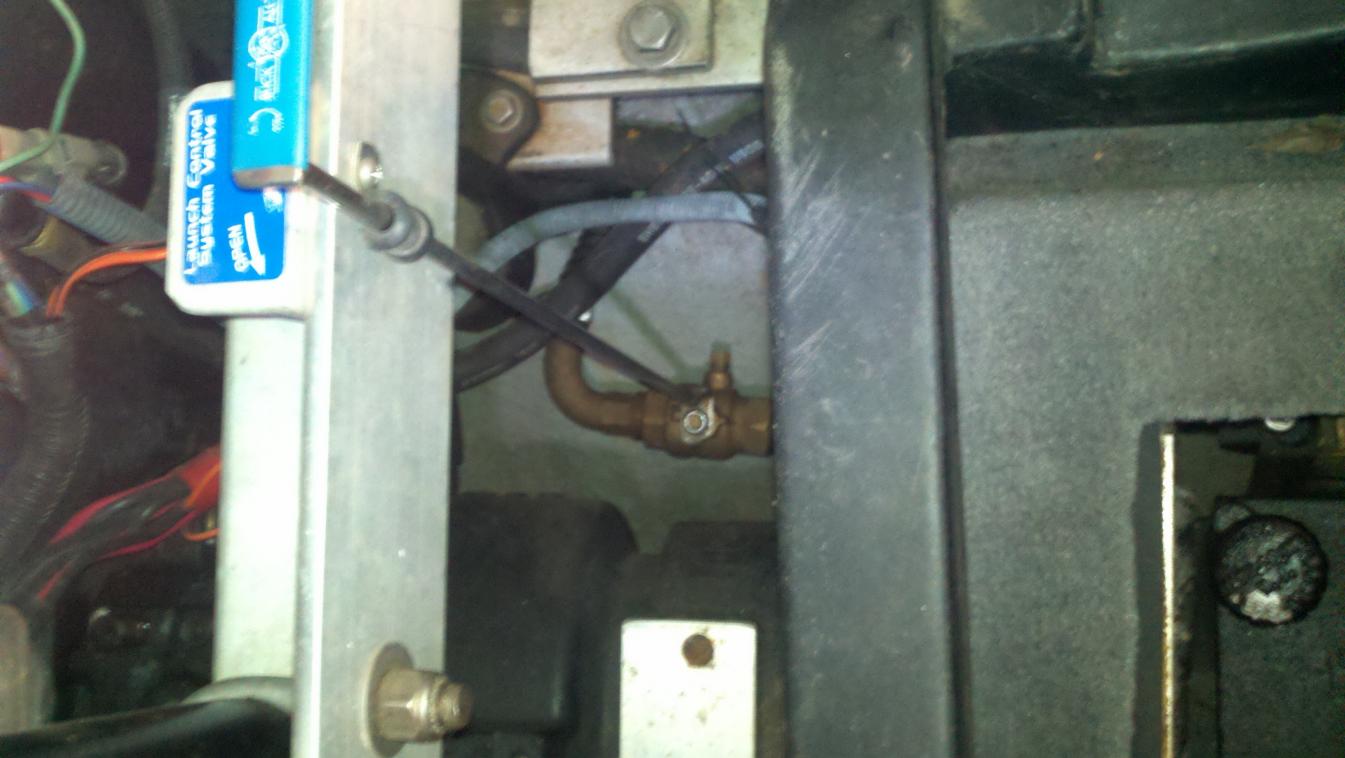

      The ball valve emergency shut-off is very close to the v-drive unit. If you pull the back seat, you should be able to see it. There should be an extension rod connecting to it that is visible near the mini tow pylon.

        Bayliner, I can send you a pic. PM me your digits.

            Aha...thank you. I saw that....but mine's got no lever attached to it. I'll have to find a lever to get ahold of it with I guess. Clockwise to close, counter-clockwise to open?
            So the intake is just the one side, and the other side..? I followed that line up to a white thing that looks like a cartridge filter.
            Are you guys leaving the ball valve open all the time? If this one line feeds both tanks, then I've got another issue if one tank is filling and the other isn't, yes?

              I usually leave the ball valve closed unless I am filling or draining the tanks. The cartridge apparatus is the strainer for your engine cooling water. That is something that needs to be looked at frequently to make sure it doesn't get stopped up.
              On my boat, which I believe is all original, both ballast tanks fill from a single intake thru one valve, thru one pump and then a "Y" or "T" to the tanks. I leave the the vents closed while filling but I do open them while draining. When one tank fills up before the other just plug the thru hull overflow, forcing the water to the other tank and close the ball valve when done. It isn't the best system for sure and I do plan on upgrading but i'll deal with it for now. Hope this helps.
