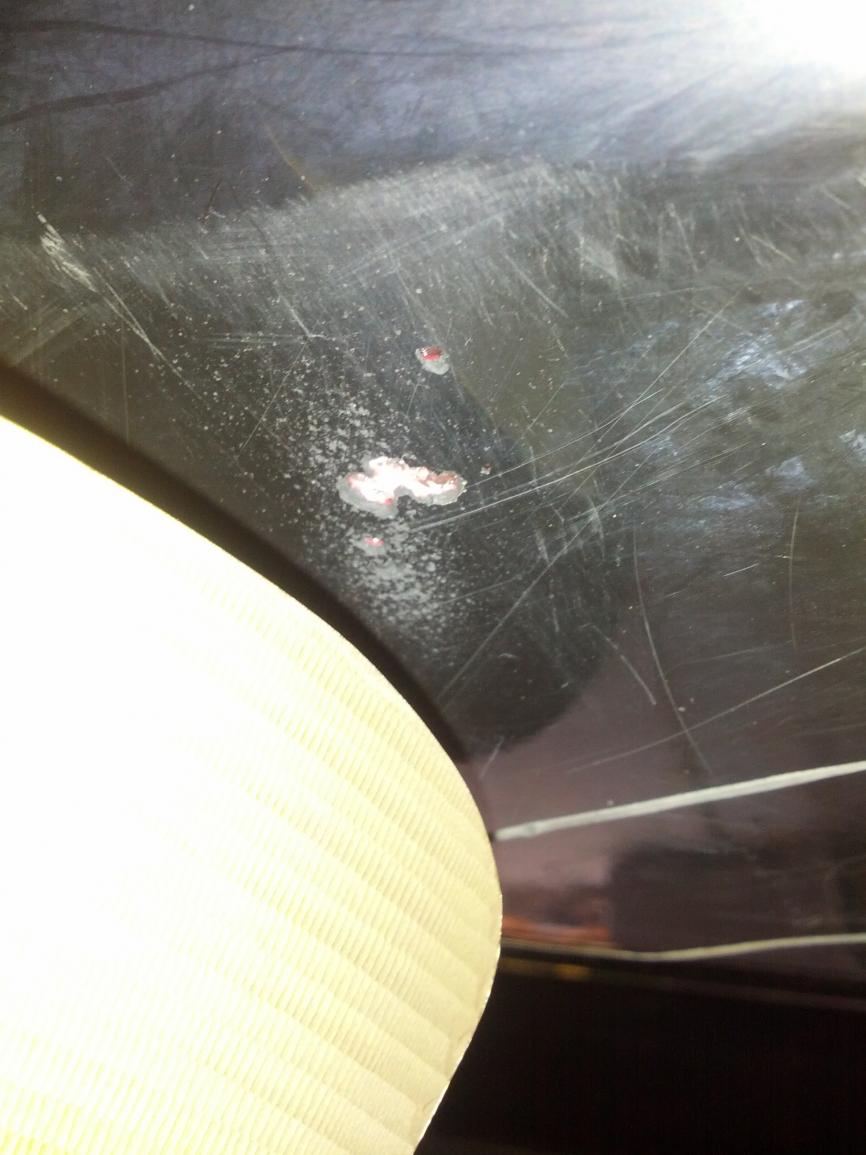

              Gel Coat Burning: Confirmed.
              I swapped out my 1579 prop to a 1235 prop back in mid-April. This is on an 08 210. At the time of the swap, there were no issues. Saturday, I checked the prop area and noticed this, about the size of a dime, with many pin holes surrounding it. So I'm confirming this, that gel coat "burn" is a reality. I'm not sure why some people experience it and others don't. I use my boat pretty heavily, about 4 times a week. I also run in the TN river, which could have more particulates in the water than lakes. Just a guess.
              All this being said, the 1235 is an excellent prop to push a 210. The benefits are very noticeable. I will continue to use this prop. I plan to repair the gelcoat ASAP while the damage is minimal and then cover it with an aluminum adhesive backed patch to protect the gel coat from further burn.

                  Is that pic from before we rode Saturday or after? I don't remember that much damage before going out. Where did you find a piece of aluminum with adhesive backing?

                    It was from before. I took a picture while we were down there looking at it. I'm gonna get something on it quick though. I can really see this as being one of those cases where the damage, once started, really gets bad quick if you don't do anything about it.
                    I'll probably check McMaster Carr first. That being said, there is probably something in my garage that would work, if I could only find it...

                          Comments made to me by an ACME rep were that slight differences in the mounting location of the motor and or slight differences in the hulls between boats can produce differences in the shaft angle resulting in tighter clearance for some 210s. He explained that is why some owners see prop burn and others do not.
