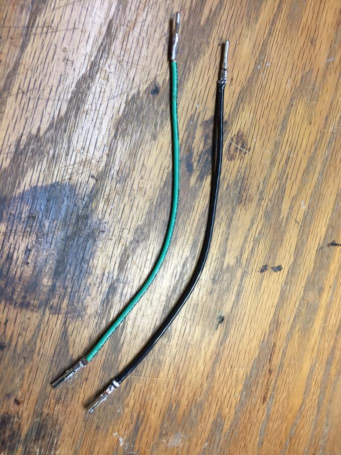

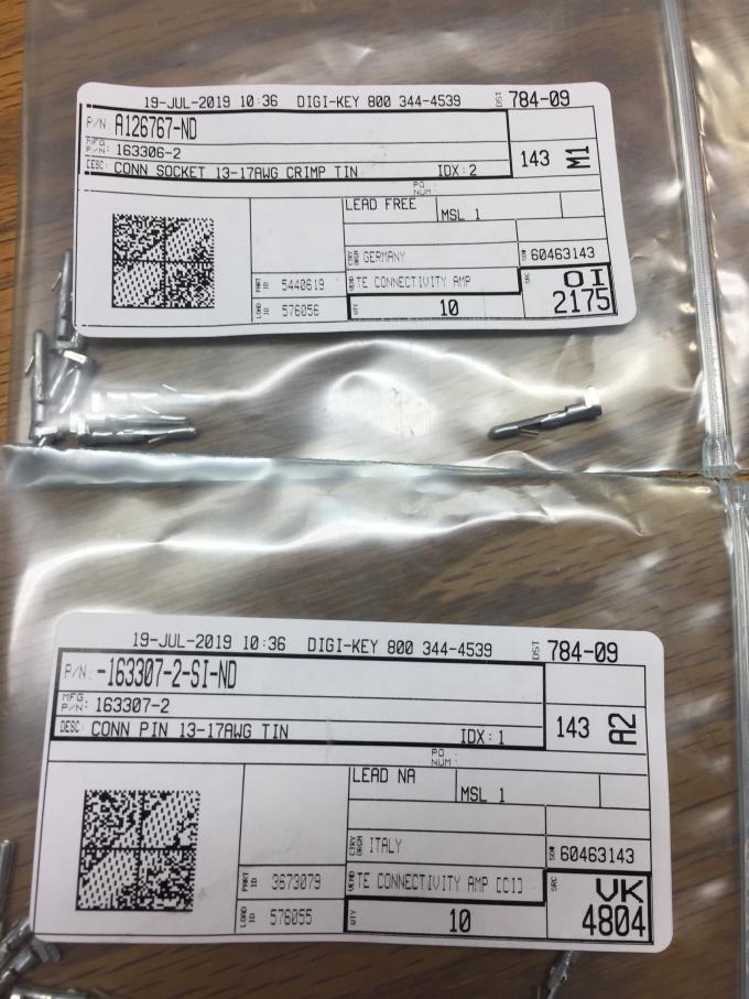

            I created a simple jumper that can be placed between the connector on the ballast pumps. On my boat the starboard and port ballast tanks are easily accessible, not so much for the belly. Attached is a picture of the jumpers and the associated connector parts. They can be purchased at Digikey for next to nothing. I used 14 AWG stranded wire. All you do is unplug the connector, put the jumpers in reversing the polarity, and push the dash switch to the "fill" position. Because the polarity to the pump is reversed the pump will operate in the empty mode, ignoring the "run dry" function. WARNING, if you short the 2 wires together with the pump operating the breaker will pop and you will have to reset it. This happened to me while I was messing around. Also, make sure you shut off the pumps when the tank is empty. You can hear an obvious change in the pitch of the pump when it's empty. It seems that older boats, like mine, have a standard 2 pin connector that I can not find. This uses a 2.1mm diameter contact that is roughly equivalent to the contact in the attached picture. Newer boats apparently have moved to a Deutsch DT type connector which uses a 1.5mm diameter contact so they are NOT interchangeable.
            Good luck!! Click image for larger version
