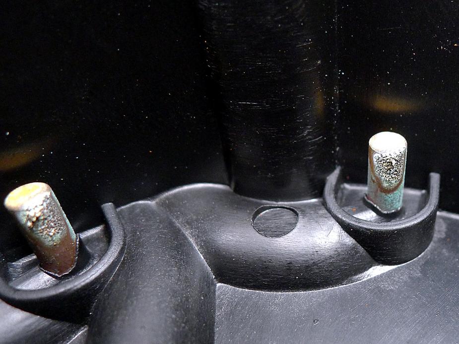

    Got it home and checked the distributor cap and rotors (I'm guessing this is the problem)
    I replaced it only 1 year ago though... is this normal?

        What parts is shown on your photo? The rotor or distributor

          The contacts on the distributor cap is what is shown in my picture

                    wakebrdr, that cap has seen better days but it might not be your only problem. like drock said you really need to see what your fuel pressure is when the problem is going on. If the lift pump is crapping out the FCC will go low on fuel and the high pressure pump will have no fuel to pump. There should be a Schrader valve on the top of the FCC where you can measure the high pressure fuel.
                    Don't forget the rotor when you replace the cap, I imagine it looks about like the cap.

                            In the short time I had after work today I went ahead and replaced the cap, rotor and also the fuel filter.
                            Took it for a quick spin and it ran perfect, although I only had it out for about 15 minutes...

                              For my problem i check my rotor and distributor and it was like yours
                              But it was not the problem
