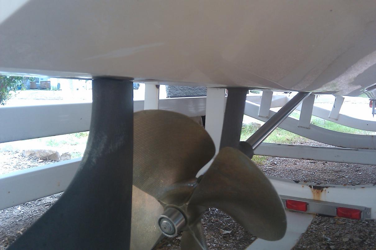

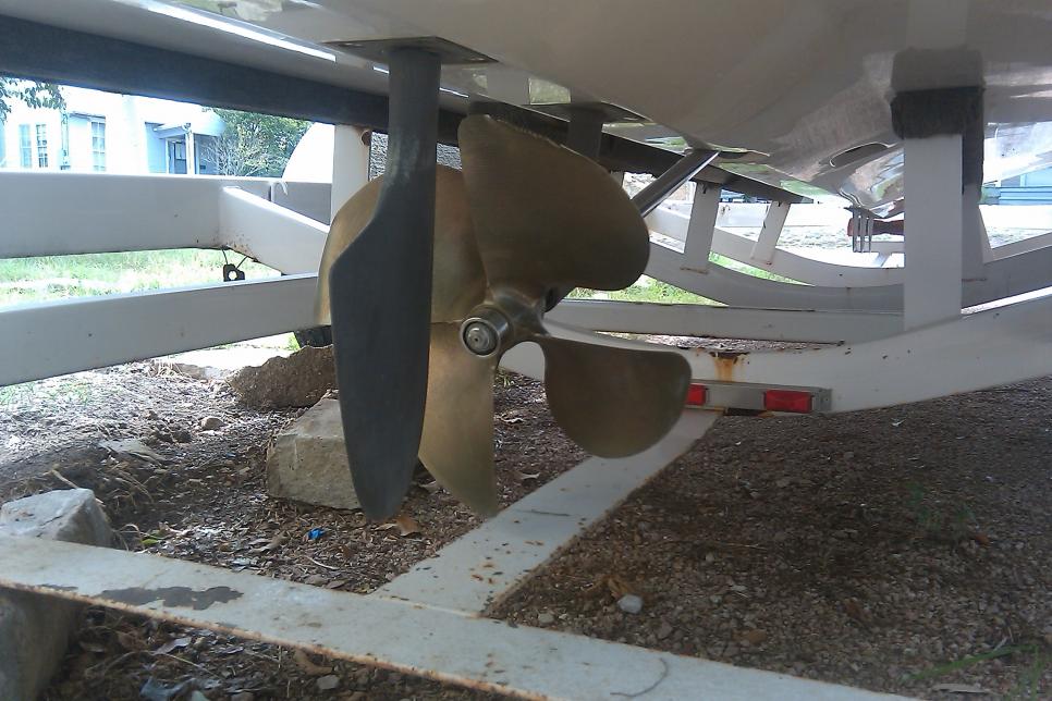

                  i called acme directly and the 1234 is what they recommClick image for larger version
ID:	362287Click image for larger version
                  1996 Super Sport

                    Natedog.. thanks for the photos.. Here are a couple of mine.. I have ni-bral 14x18 3-blade now..... it does 40-42 top speed, but cant plane out with full ballast. I emailed Delta and they said acme doesnt recommend it for my application?? using the #1234, so I emailed Acme direct to see what they say (just in case).... I have a 14 on there now and I still have a good 1 inch+ of clearance to the stainless plate, so a 14.5 (#1234) shouldnt be an issue when it comes to clearance, thats only .5 more diameter. I dont see a problem fitting that?? I dont want to go to a 13.5 as suggested by Delta... thats .5" less diameter than what I have now!? doesnt make sense. I have a Gt-40 with 310 HP, it should have any problem turning that 14.5 prop. and it would fit...??

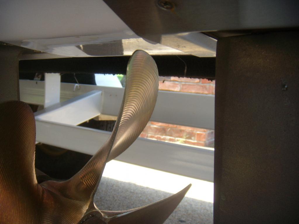

                            This is a 1272 on my o1 SAN. This is how close a 14.5" prop is on our boats. Its way closer than I would have thought was safe, but the prop is bad to the bone. I love the performance.

                              WOW, that is close.. looks like about .5"... but you have the stainless guard and the prop is not going to get any closer, so as long as the gel coat is protected.... I will get the #1234 and post some pics, but Im sure they will look like Natedogs!
