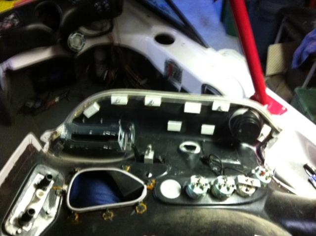

                Here is a fuzzy iphone pic of the backside of the panel from my 200 AN DD. You can see the 4 studs. Also, I meant to say vertical studs/bolts (not screws) in the post above. In any event, I hope this helps.
