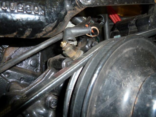

The engine is a PCM GT-40. Can you tell me where the temp sender is located?
It should be located on top of the circulation pump, (not to be confused with the RWP). If you look down from the top on the front of the engine, the end with the two belts, you can see it. It is located behind the largest pulley that both belts run on. It is brass with one wire comming off of the top. On mine, it was slightly angled towards the RWP and set back in a little. I hope my description made sense. David

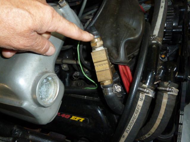

Here are the two temperature senders I found on my 1997 GT-40 engine. The one with my finger pointing to is for the computer. It has a single green wire on it. Mine is located on some extra plumbing that was added to install a heater. This sender is normally on the intake manifold, buried just behind, and to the right of the distributer.
The other picture, of the circulating water pump has a brown, or tan wire on it. Shorting the connection on it makes the temp gauge immediately peg full hot. If I connect a small test light to it, and ground the other end of the test light, the light glows dimly, and the gauge reads about half scale.
Find the temp sender with a single brown, or tan wire on it. I am not referring to two wires, I am using "tan" or "brown" because what I call brown , you may call tan. or the other way around.
