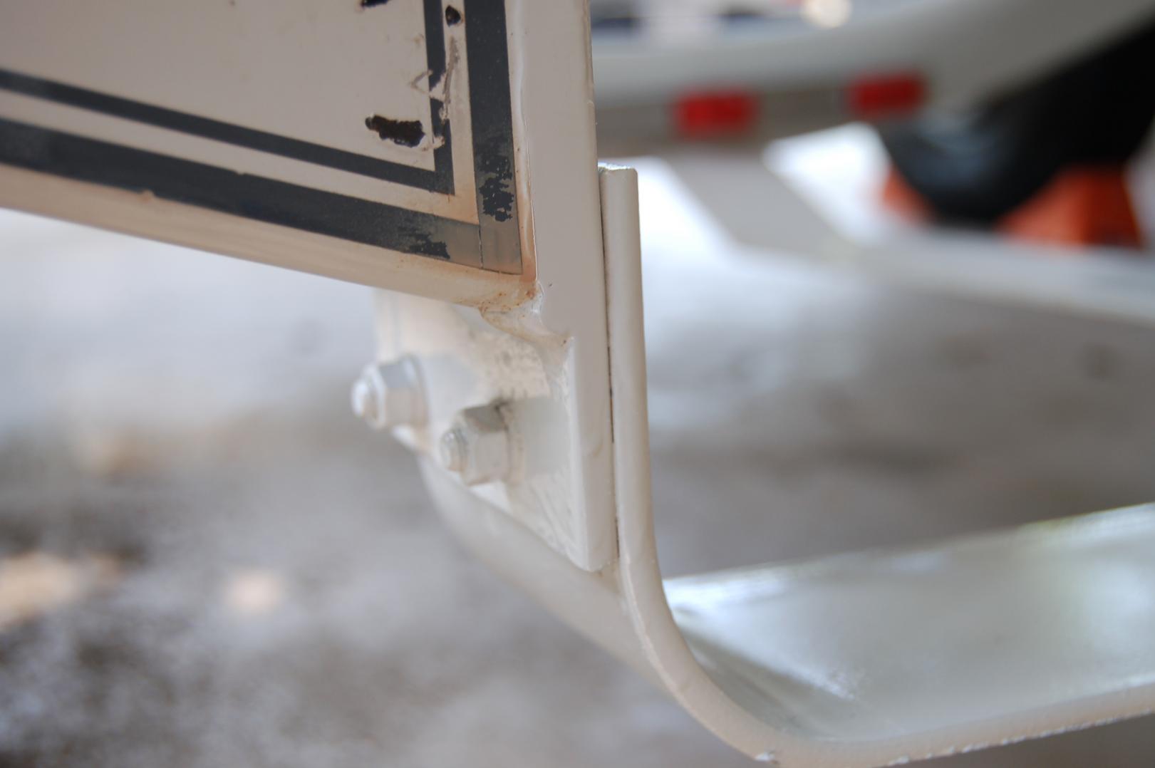

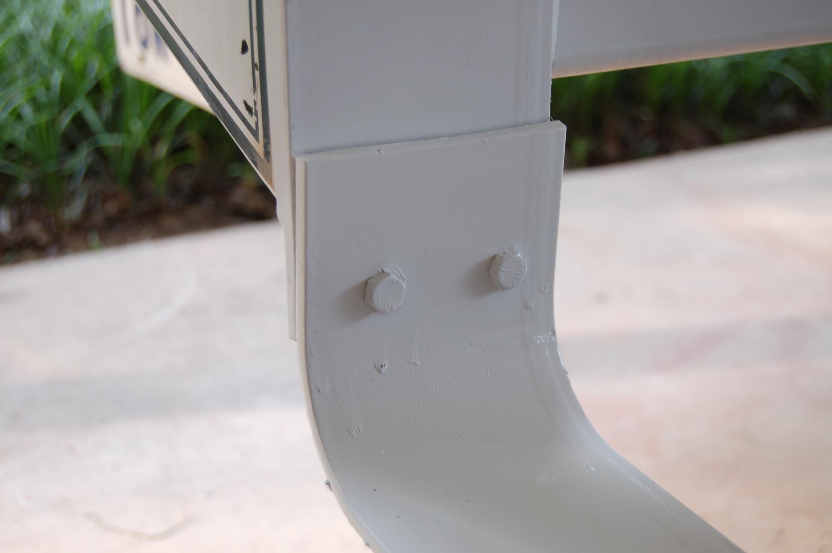

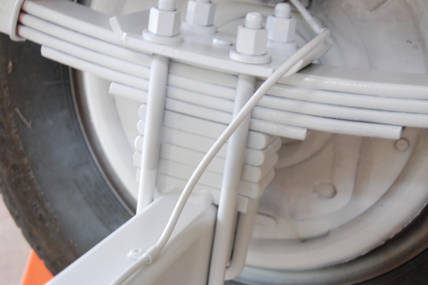

                          here are some pics of mine.
                          shows how I cut and raised the prop guard.
                          Also, the before and after of adding the lift kit.
ID:	362199Click image for larger version
ID:	362200Click image for larger version
ID:	362201Click image for larger version
                              Originally posted by cdrymalla View Post
                              Thanks, all of the info is very helpful. I will look into the rollers and springs.
                              Chris,196 - You may have said this in your prior thread, but did you just cut the prop guard, bend it to be a bit more narrow so that it fit within the upper poriton that was not cut and, bolt it in? Also, did you have a piece of flat bar that ran front to back from the center of the prop guard, i.e., uner the prop shaft? If so, did that just flex upward as you moved the prop guard up?
                              yes, I just cut it with an angle grinder and bent it inside the tab I left. Then drilled it and bolted it together. The center portion bends fairly easily. I've seen other brands of trailers where this will not work. the prop guard is beefier. But the dorsey works fine. It's also why I didn't go with rollers. That vertical member of the prop guard just doesn't look strong enough to me to support the weight of the boat. And the way the rollers attach, it seems like not all the force goes straight up, but some through the bottom bend. Anyway, that's my opinion and what I did worked great for me. I've included another pic to show the prop guard before I modified it.
