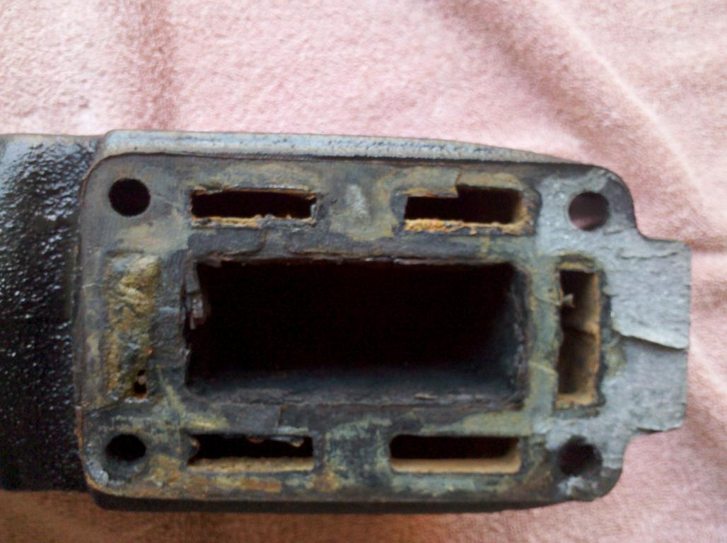

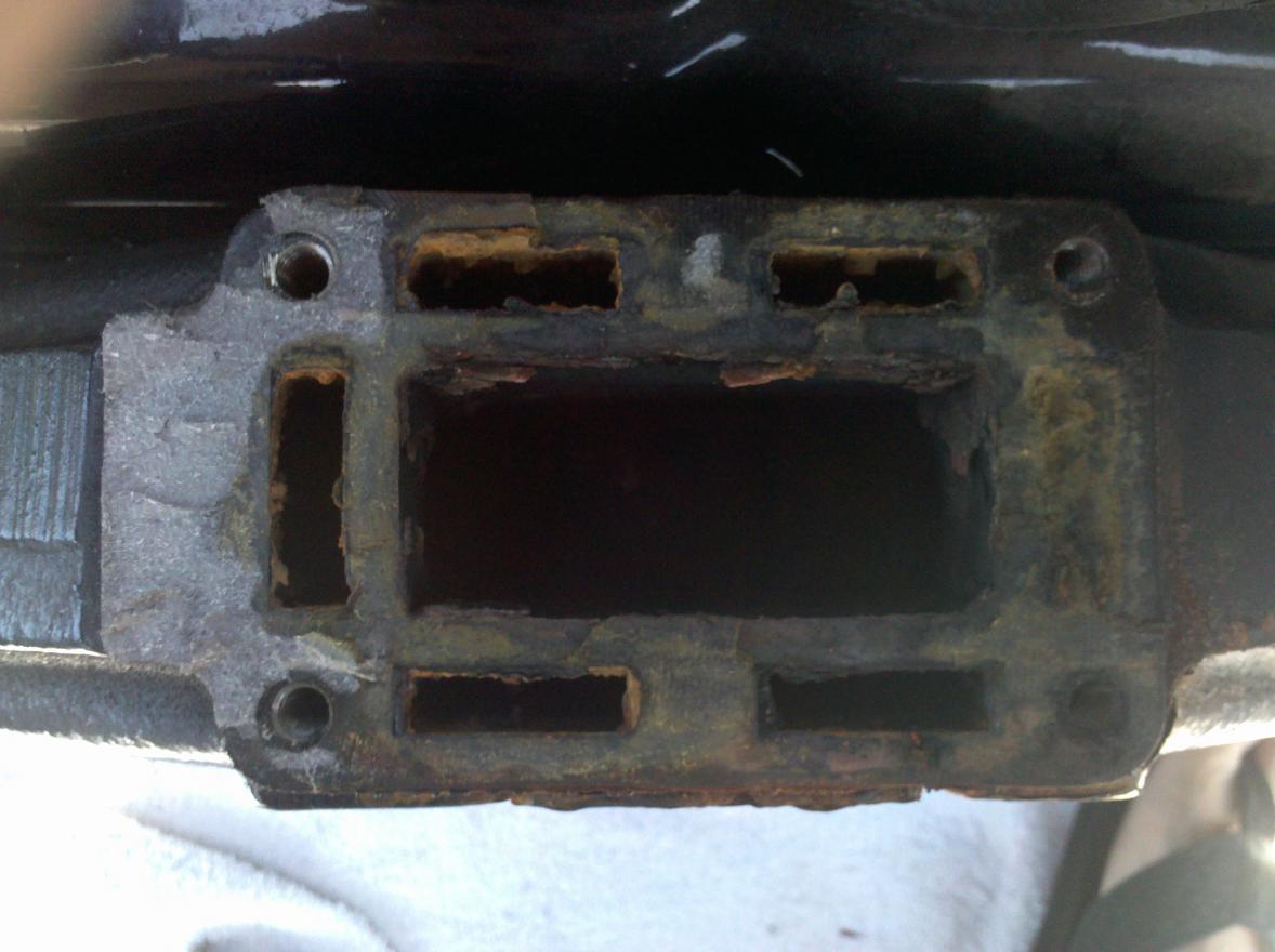

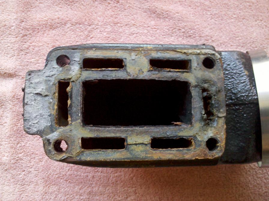

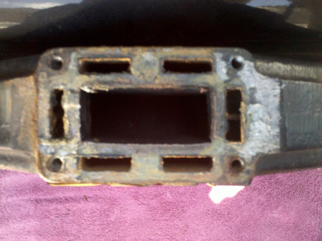

I am in the process of replacing my riser gaskets on my GT-40. I have the risers off, but what is the best method to remove the old gasket from the manifold and riser. I assume when I get the old gasket off I need to lightly sand the surface. I need everyone's expertise. I talked to Whitelake and they said after everything is clean, to place the gasket and bolt it back together. No gasket sealent required. I have attached pictures of both maifolds and risers. Looking at the new gaskets it looks like one of the ports is supposed to be closed off.

Do you have a gasket scraper? If not, any plastic scraper should be fine. Be careful not to gauge the metal, especially if you attempt to use a metal scraper. Just try to get the area as clean and flat as possible before placing the new gasket and bolting it all back together.Please do not PM me directly asking for advice on how to repair your boat. While I would love to help everyone, I simply do not have time to respond to all of the inquiries. Please post your questions on the forum, so that all of our members have a chance to answer.
The riser gasket has one port blocked. This goes toward the direction of the riser outlet. You can see it in your pictures.
Jeeze! you pulled your manifolds off the block! How hard was that? Your manifolds and risers look pretty good. Scrutinize the manifolds for any evidence of cracks while you've got them in your hands.
