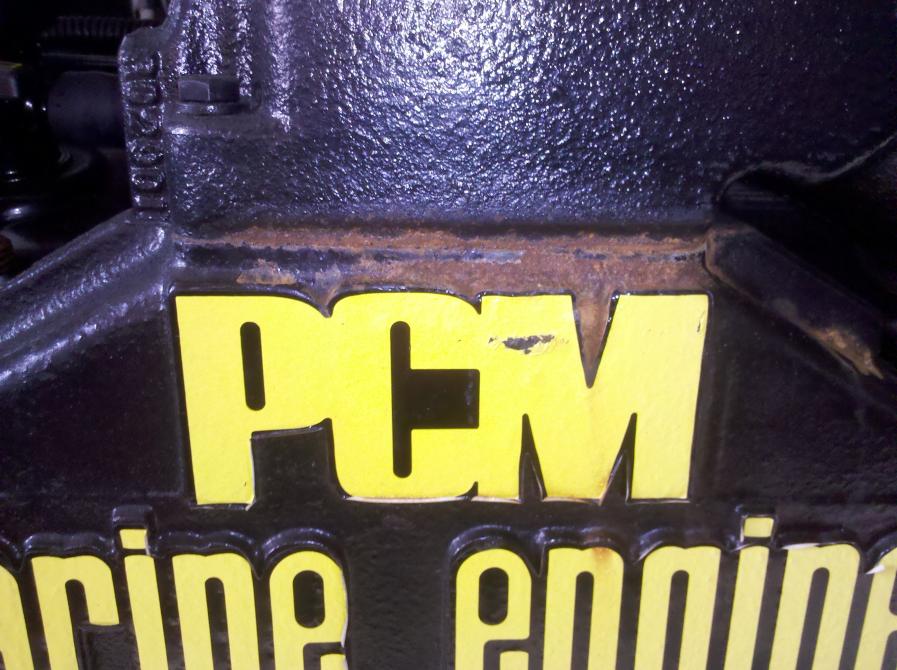

                This is the rust that I am talking about. No visible water leakage, but something is causing this to happen. If water starts leaking back into the cylinders wouldn't the oil start to turn milky, and no I don't want to wait for that to be a sign to do something.

                • BombWake
                  • Dec 2009
                  • 18
                  • Arizona
                  • 2002 Super Air Nautique Team Edition 1979 Ski Nautique
                  I would replace the manifold completely as they are a wear item IMO! On my old 2002 210, I had a manifold that looked like that and it ended up being a pin hole crack inside of the manifold that was dripping water into the cylinder! I noticed a bit of steam and smoke comming from the exhaust when winter riding as a small amount of water was entering the cylinder. It was only dripping into the first two cylinders on the port bank as the motor tilts back in that direction however, it did bend the valves on those two cylinders! Luckily we caught the problem before the crack opened up more which possibly could have hydrolocked the motor or caused a valve to be dropped. The exhaust manifolds are just a casting and can develop cracks on the inside without you knowing it. Luckly in my situation, the problem was caught before doing any major damage to the engine, just a simple head job and new riser manifolds fixed the problem. Good Luck!

                    Todd, it's hard to tell from the picture, but I think I see a water trail from the M on PCM down to the N on engine. So you probably do have a mild leak at the riser gasket.
                    And as SBRS told me "If water is leaking on the exterior, then it is more than likely leaking on the inside. If this is happening, water is wicking into the cylinders. This is not a good thing!"
                    Since the water is going directly to the exhaust valves and into the cylinders, you may not ever see water in the oil. But as BombWake mentioned, water on hot valves is not good and water accumulation in your cylinders after shut down is not good either.
                    You probably at least need to change out the riser gaskets. I really do not know if exhaust manifolds and risers have a certain life span. In salt water, they might last only a few years. In fresh water - who knows? You just have to somehow know if they ever crack inside where you can't see it, ha ha. If you ever see cracks outside, you gotta replace them fast. If you see evidence of leaks at the manifold/riser junction, you gotta at least replace the gasket. While the riser is off you can look inside the exhaust area a little ways to see if there are any telltales of leaks.
                    I'd like to know if there is a known lifespan to manifolds and risers. I've seen risers last in fresh water over thirty years. Manifolds have more abuse with the heating/cooling cycle and may develop failures sooner.
                    Good luck, and let us know what you do!

                    • gmdattilo
                      • Apr 2010
                      • 30
                      • Louisville KY
                      • 2000 A-N
                      its probably worth noting that there are no water passage between the manifolds and the heads. even if you have a leak at one of the exhaust ports you will not see rust trails. the gaskets at the exhaust ports in the heads are high quality, high temperature material. the riser gaskets are typically paper and are quite prone to leaks. unless you hear an exhaust leak at the exhaust ports I wouldn't mess with it. like the others have said, its possible for water to run into the cylinders (or closed valves) from leaking riser gaskets, but there are no water passages at the exhaust ports. the cylinder heads are the same castings as those used on automotive engines that are cooled by air. water enters the exhaust manifolds through the two hoses coming from the t-stat housing.
                      if you run into stuck bolts pb blaster is pretty good stuff but if you can put your hands on kroil oil you will fall in love. soak them down good with which ever penetrating oil you can get and use a torch, heat is your friend, just stay away from fuel lines, carpet and fiberglass.
