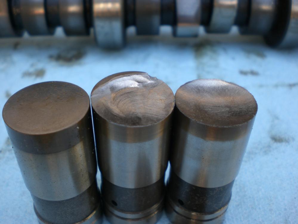

    Two of my lifters were concaved pretty badly and about 4mm shorter than the rest, which I discovered doing a head gasket replacement.
    I am not sure I must replace the cam, but I think it makes sense. I swaped out the concaved lifters with lifters from the other head to get a measurement of sorts on how much the lifters are actually traveling? The intake lifters on the 2 and 3 cylinders ports rise about 1/8 of an inch less then the remaining lifters. Yes I know this is not optimal.

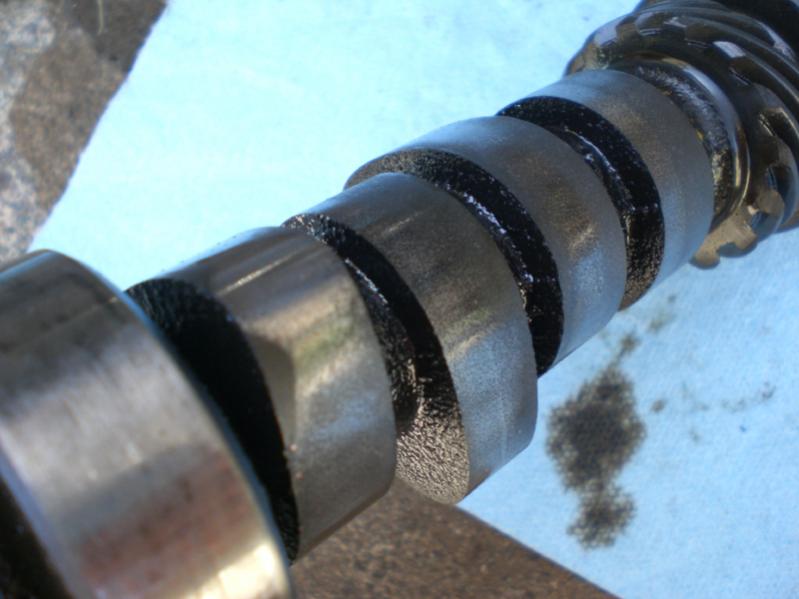

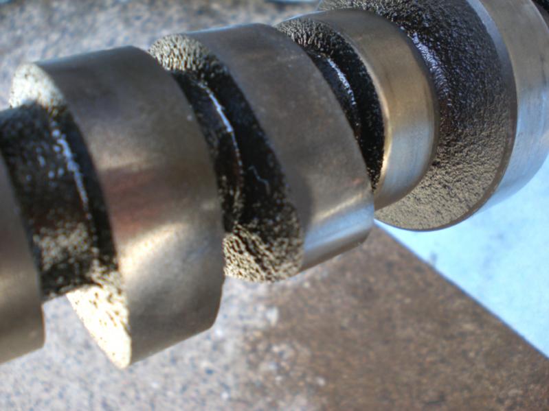

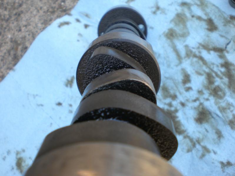

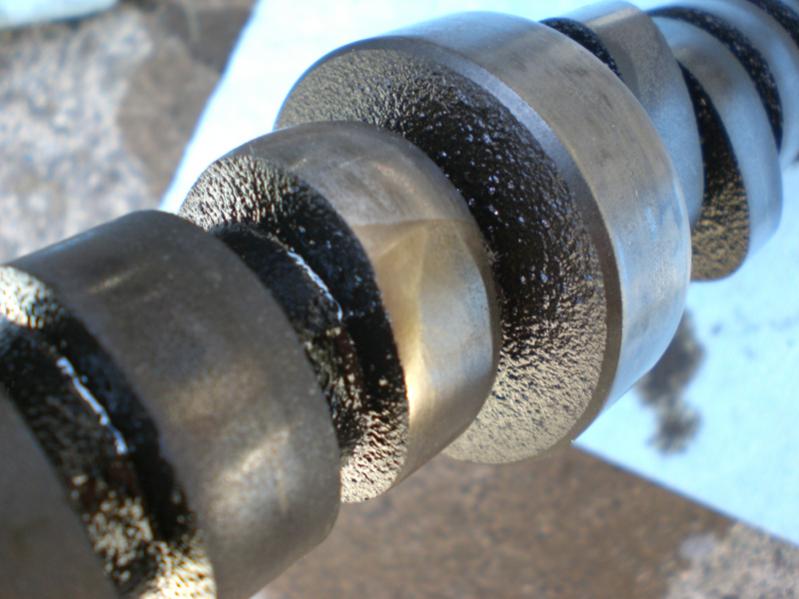

    Okay so me being me, I did some research as to what good versus bad cams look like, and what is acceptable cam lobe wear. I did a google search "accptable cam lobe wear", and found a number of forums and data. The one that actually had something sound came from Summit Racing.
    http://www.tpub.com/content/construc...346-140178.htm
    So then I decided to take the cam out, even though I have never done anything like this since the clearance from the head I mentioned in my previous post seems far ouside of what would be accptable or so I presumed. I found a good link that illustraded how to remove the cam for our motors...
    http://www.spartaperformance.com/caminstall.htm
    I removed the ski pole and went to task. Everything went just as diagrams except one thing. The crank pulley is slightly different on our 351's than the illustion. We have a two piece pulley which I did not pay attention to and I pulled the pulley off the base, like a dummy, so I need to press it back on - which should be alot of fun to figure out. (enter profanity and dropping of head here). For those who are not sure why this is important, the mark that lines up with your timing nail thing on the block is on the pulley. So when you remove the pulley and still have the base on the block you had best have TDC set right because your timing mark is now wrong, untill you repress the pulley with TDC established. UGH.

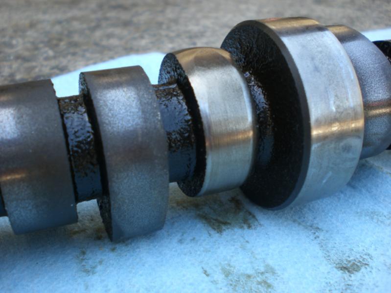

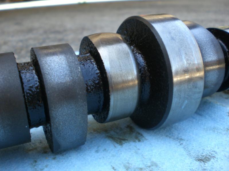

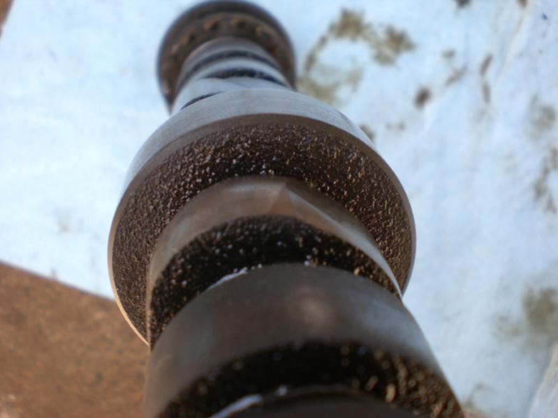

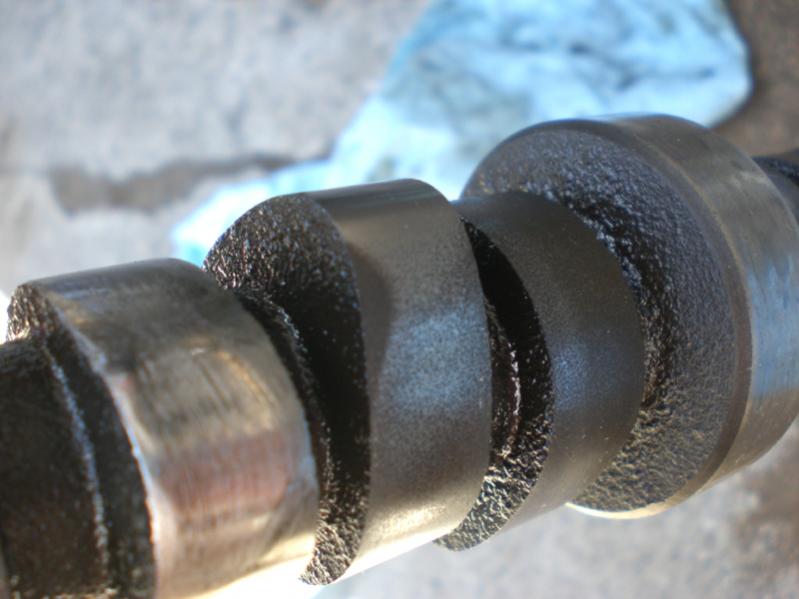

    Anyway the cam slides right out and no probs. I did take pictures of the cam and lifters to show what I experienced. Why? Well all of my compression read 100-120 which was lower than it should have been. Whitelake said 150-175 is wear you want to be. I had leaking valves which contribute to this. Another factor I learned is if the lobes are worn and your lifters are flat your engines pistons will not expand fully and can somehow lead to a valve leak. This is what I read online so don't shoot the messanger
    Anyway all of the lobes had wear, so they were losing their peak. I understand this is normal since you have hardened steel rubbing on hardened steel. The two lobes that had the 0-90 compression where the lifters were sticking were totally rat, and almost fully round and roughed up. This occures for a number of reasons, likley low oil causing the lifters to essentially weld to the cams as they spin. That ticking you may hear in a motor is the weldings potential occuring, and the lifters chizling the cam. Good times.
    I never had any ticking until I started the motor this last time to do the compression test, and it dissipated after 30 seconds. I am not the original owner though, and one of my heads is a replacement that the past owner had done, so this likley started before my reign. The motor never had a problem pulling heavy skiers so easy to ignore a problem like mine developing.
    My thoughts are for those of you hitting 90-100 compression and have no leaks and are not missfiring, there is a really high liklihood your lifters and or cam could be tired and needing replacement according to the machine shop who did my headwork. The parts just wear out.
    I was unaware of all of this untill a week ago. Who would have thought a headgasket replacement would have led to all of this? I know I did not. Hopefully this experience helps someone out there.

    • Lewy2001
      • 63
      What type of oil have you been running in this engine???
      • mrbobolina
        • Sep 2008
        • 107
        10w30
        • Chexi
          • Sep 2026
          • 2119
          • Austin
          • 2000 SAN
          Have you been running oil with zddp? The engine should be run with straight 40 weight with zddp. I've heard of people using some split weights with decent results, but I don't recall anyone using 10w30

            Sorry just checked the service record. It is 40w. Not sure what the **** I was thinking.
