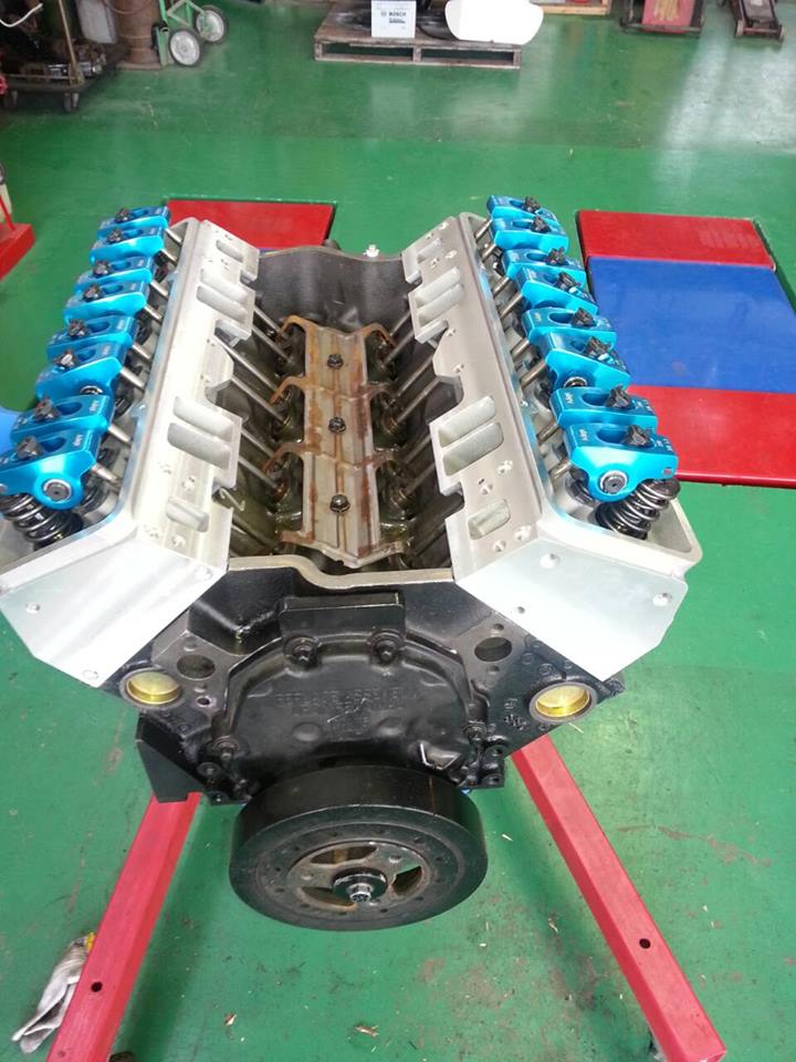

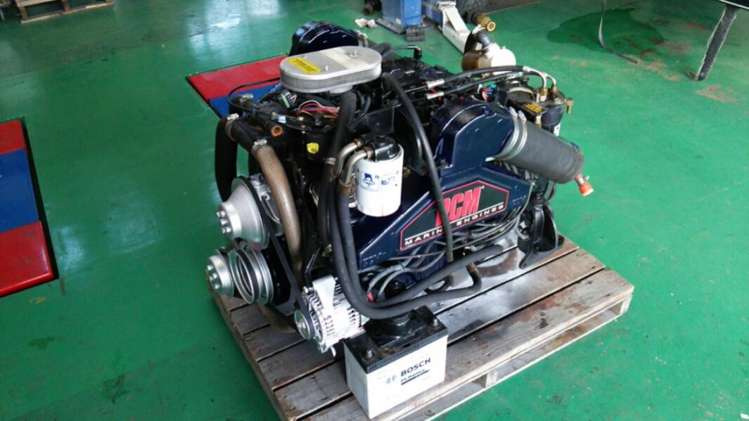

I am building ex330 to 383 stroker.
I used eagle rotating assembly kit and neutral balance flywheel.
Also, I use stock MEFI injection system and any other component.
However, I needed to rewrite the MEFI file.
It needs exclusive softwere.
It has power more powerful than ZR450 and ZR409.
It has around 450hp to 500hp.
