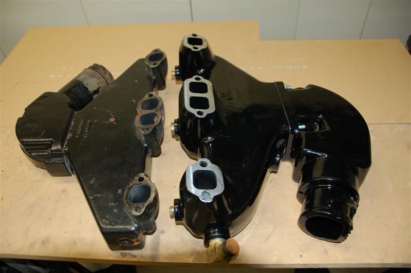

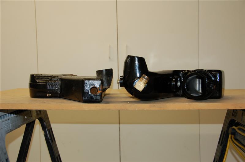

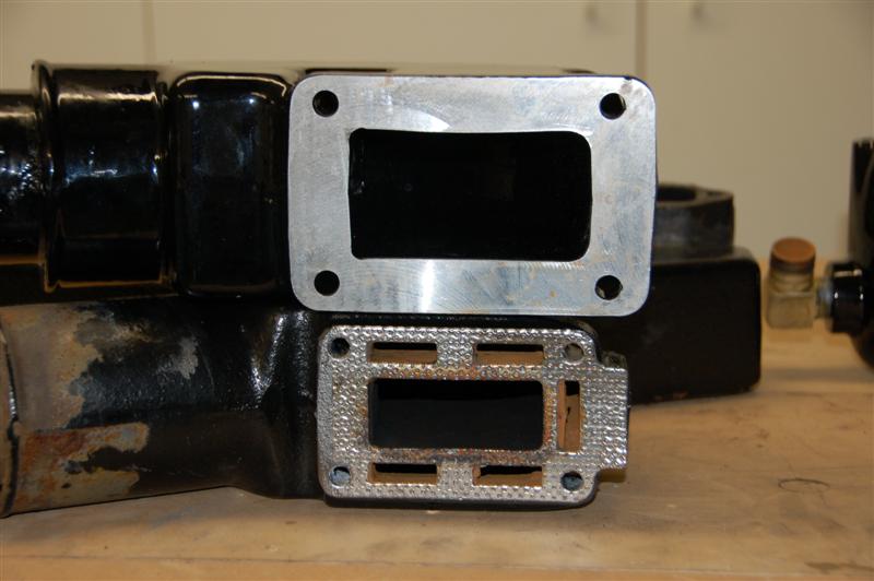

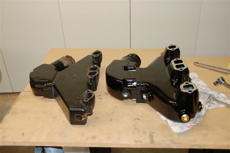

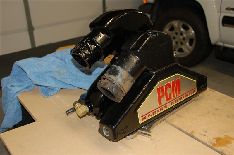

                            Yep,
                            I did some serious digging before I dropped the idea altogether for a variety of reasons. I did however install a set of eddie marine aluminum exhaust manifolds and would recommend you do the same. I even spoke with PCM about it and they said the stock tune was plenty fat to keep the motor from hurting itself if it ran a bit leaner.
                            I would not ditch the stock EFI system, there are plenty of guys that know how to make them work correctly and off the shelf software systems that would allow you to tune the ECM yourself. My motor is controlled by the MEFI 4b processor, if yours is drive by wire I believe that is the MEFI 5 processor. I would run the MEFI 4b, add O2 sensors in the exhaust elbows and run it in closed loop mode. Switching from open loop on the 330EX to closed loop on the 343EX allows them to run tighter fuel curves resulting in more horsepower.
                            The motor I almost put in my boat was going to be a dart block with Edelbrock aluminum vortec compatible heads bored and stroked to a 409 cubic inch motor. My target was to have over 400ft lbs of torque from 3000rpm through 5000rpm, with a peak around 500ft lbs around 4500 rpms. I would guess the motor would have made about 500hp. It's pretty easy to get there with 409 cubic inches and MEFI controlled EFI and ignition. I still have the spec sheet from Larry's marine engine in Arizona in case you are curious, email me if you want me to send it to you mikeskiw@gmail.com
                            I also considered a whipple supercharger. Either way I was looking at over $7k in hardware and ECM programming even if I did the installations myself. I had the cash ready to go but I realized it was a better decision to buy another boat which I did. I actually just sold that second boat since I didn't use it much in the past 2 years (2007-2011).
                            I use my boat for wakesurfing with fresh air exhaust. I also thought about cutting another hole and installing a second through transom port for full duals as you did but I don't want a loud boat. I still have a pile of 4" stainless steel pipe and mandrel elbows lying beside my shed with part of the exhaust already fabricated.
                            In 2009 my twin boys came into the picture and gobbled up most of the free time I had to work on my boat. This was a large factor in my decision to abandon this project. In 2011 I started working for a start-up company, between my 3 year old boys and my job now I have zero time for cool boat projects like this. It's crazy, I still need to find time to change my impeller and oil for this season. Luckily I have the boat functioning almost exactly as I would like it to function. That said, this thread makes me consider hauling the boat down to the whipple factory and have them add the supercharger.

                              Forgot they are actually Revolution Marine manifolds, similar to Eddie Marine.
