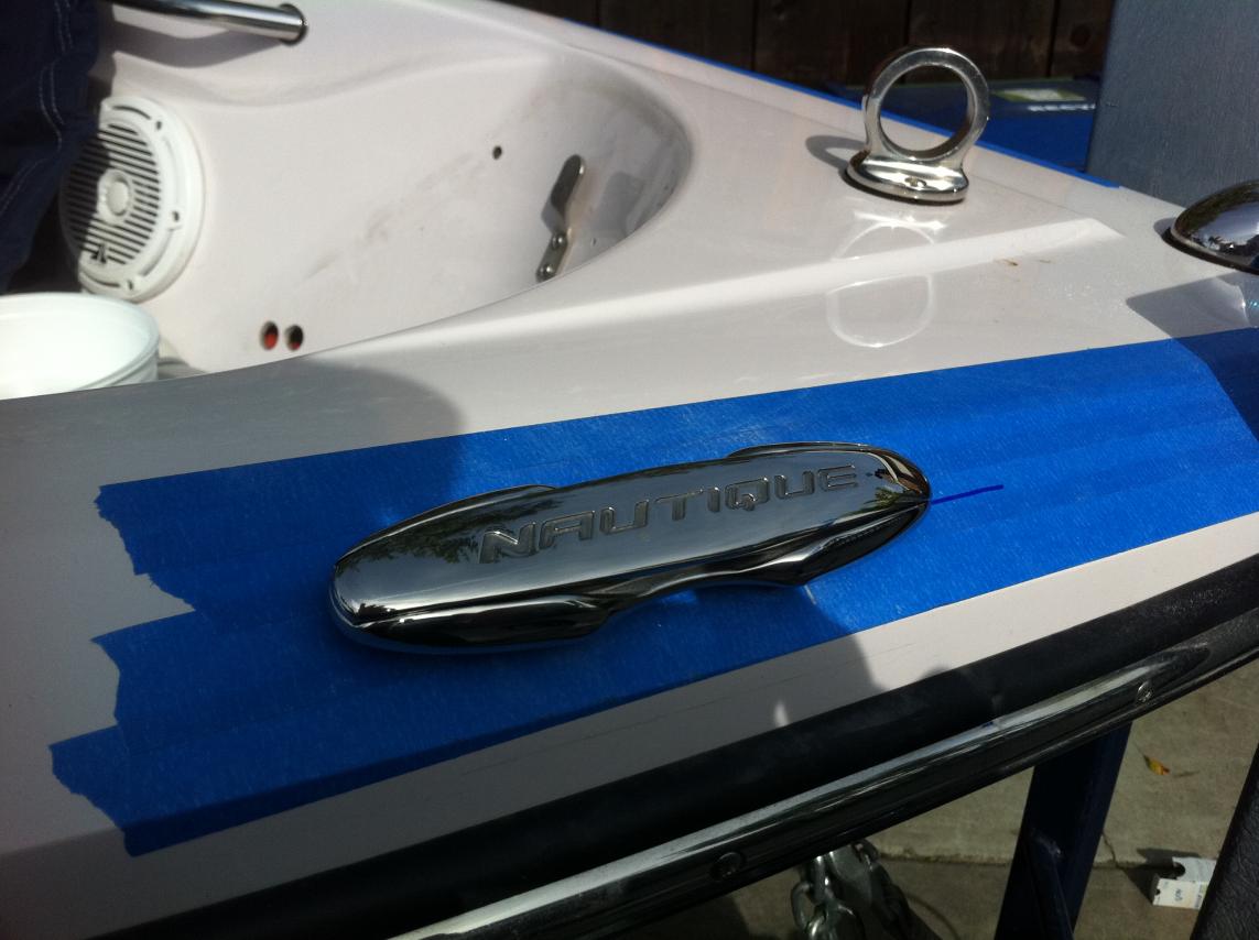

    I am going to mount two pop up cleats on the bow of our 2006 SANTE 220. Any advice on the best method to drill the very large holes and not chip the gel coat? I tried on an old ski locker door with a step bit and had good success.

    Use tape on the gel coat, then mark the location. Measure 3 times, drill once. Use a smaller bit first, then graduate to a larger bit. then I would counter sink the gelcoat a slight amount to avoid pressure on the edge of the gel when the cleat is inserted and tightened. distribute the load of the bolts evenly. Your step bit might be the answer.

      I used a NEW hole saw bit, the exact size needed. Taped the surface with painters masking tape and drilled away. Perfect holes, with no problems.

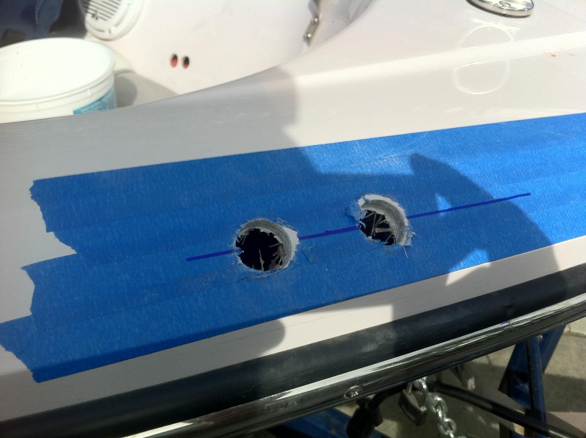

              Sounds like you and I are doing a lot of the same projects, you will love the FAE, and as far as drilling into the hull to place popup cleats, this is what i have done the past and it works great.
              1. Measure measure measure measure, mark off measure measure measure then maybe cut
              2. Tape the gel coat off with painters tape
              3. Run the hole saw cut out for each corner (or side) of the hole you want in reverse slowly until you get through hull
              4. Use a rotozip tool (or the equivalent) to connect the holes for the desired cut out side (still using the painters tape to cover)
              5. Use a dremel sanding rotor tip to create a small bevel along the edge of the cut out to relieve pressure from the gel coat and decrease spider cracks from forming.
              6. Place in the recessed cleat, seal with a marine silicone product, etc

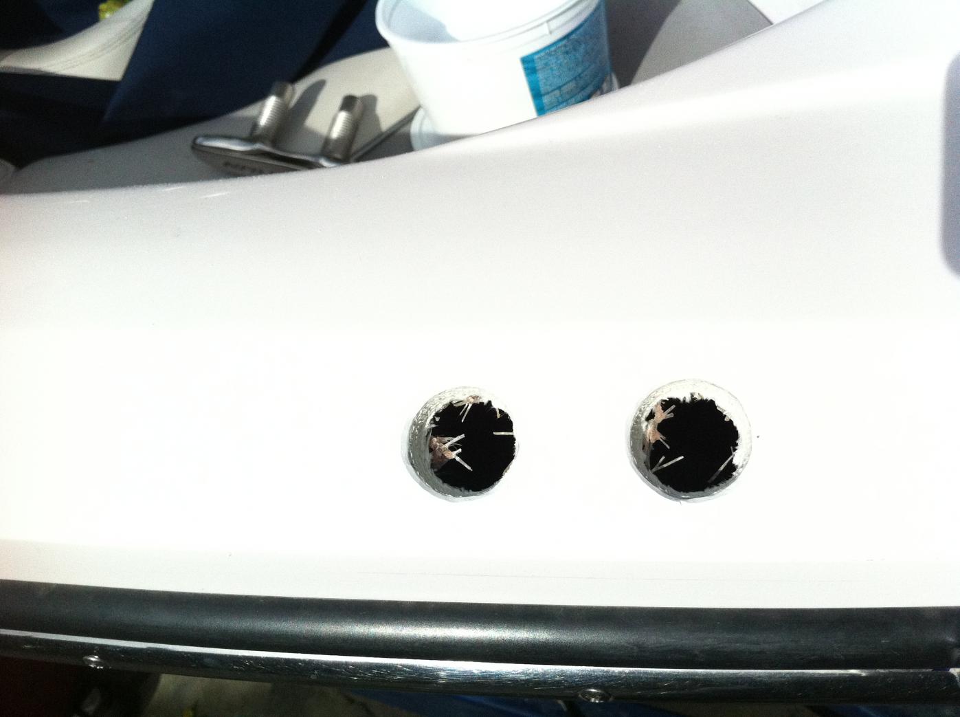

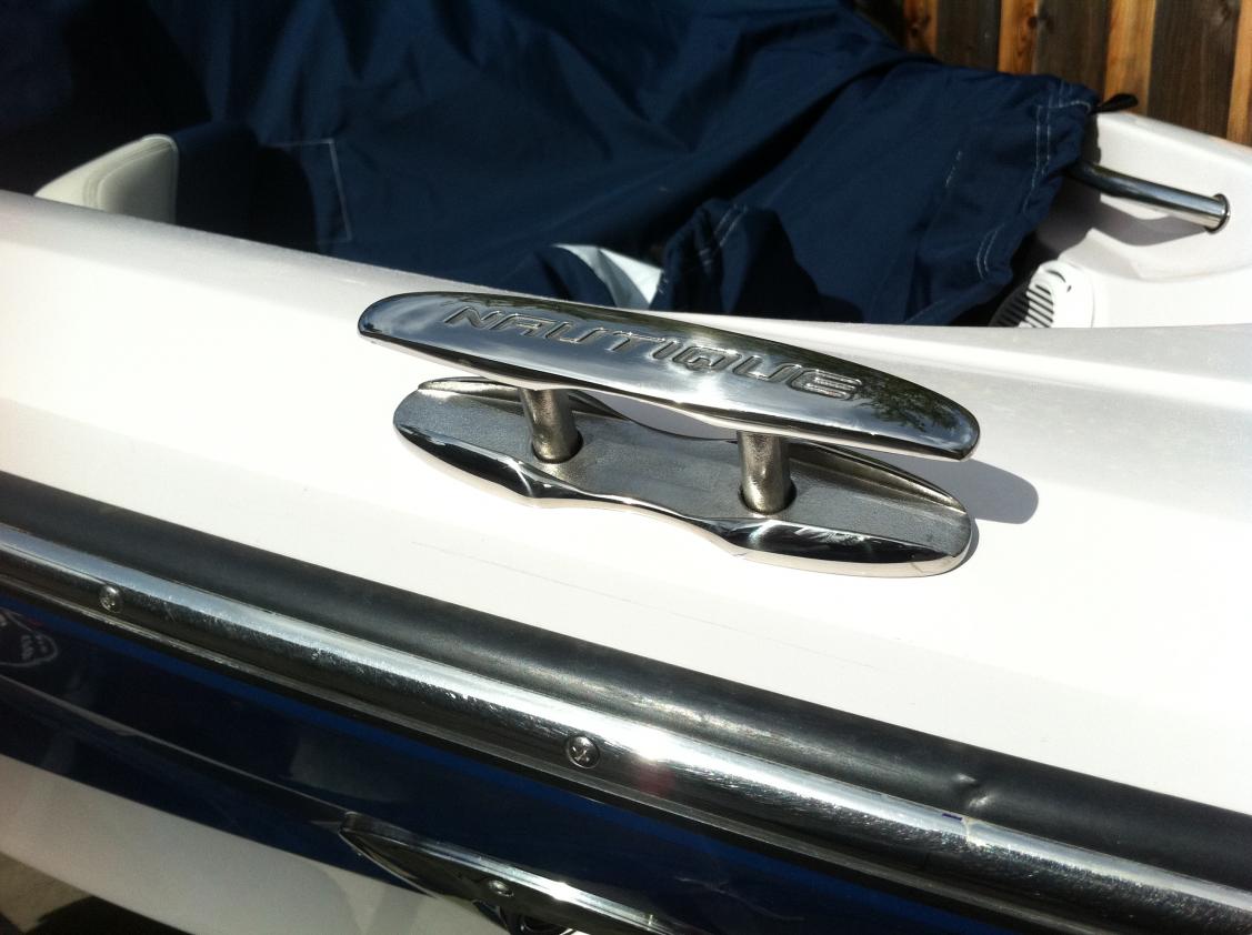

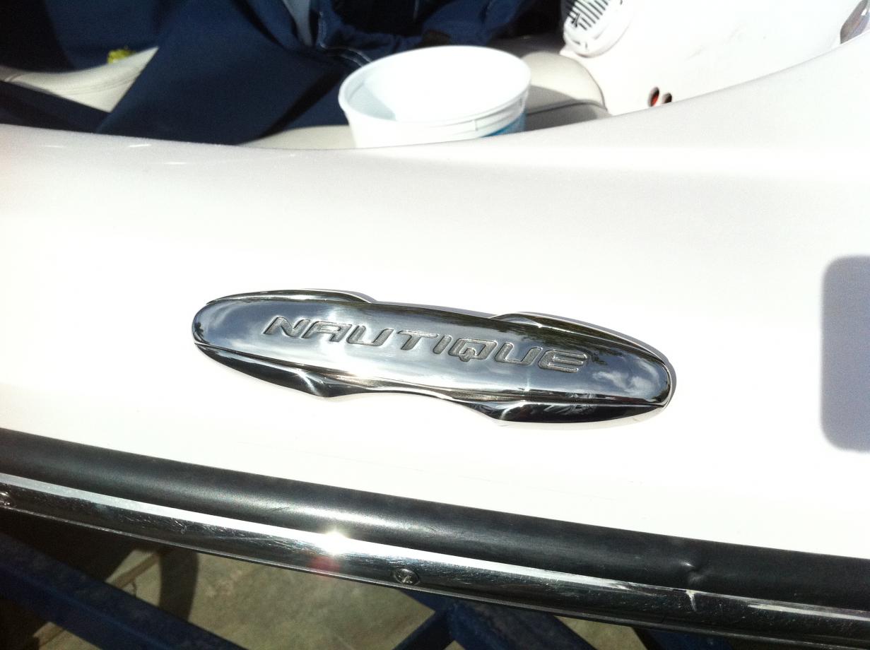

                          Holes drilled not to find a big a$* socket
                          THANKS for all the great advice the hole drilling went great. Had to pucker a bit when the pilot bit goes through and the teeth slam into the gel coat. No nicks and beveled the edges. Not I need to find a **** 1-1/4 deep socket!!! No luck today so far.
