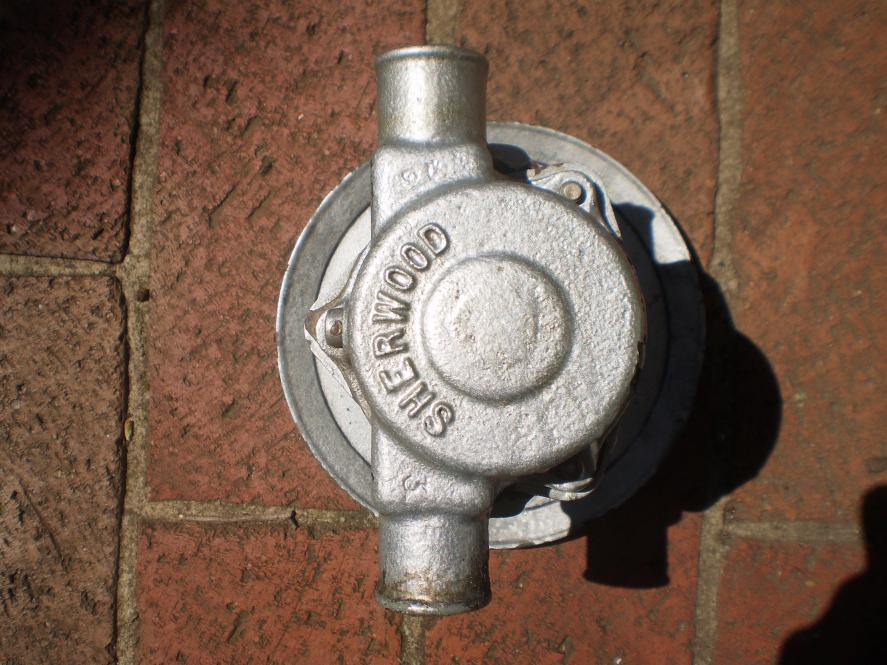

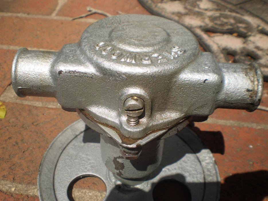

        Does it look like this? The two hoses should be on the block side. I put the arrow on mine so I get it right every time.

          nautiquehunter,
          looking at your pictures, it appears that i should have the hoses on the block side. I have attached pictures of my hosing. Do you agree. I really apreciate your help. Thanks so much.......
          • Nautiquehunter
            • Jun 2008
            • 2099
            Yes hoses to the block side. Start it on a hose and check the exhaust for water coming out.
