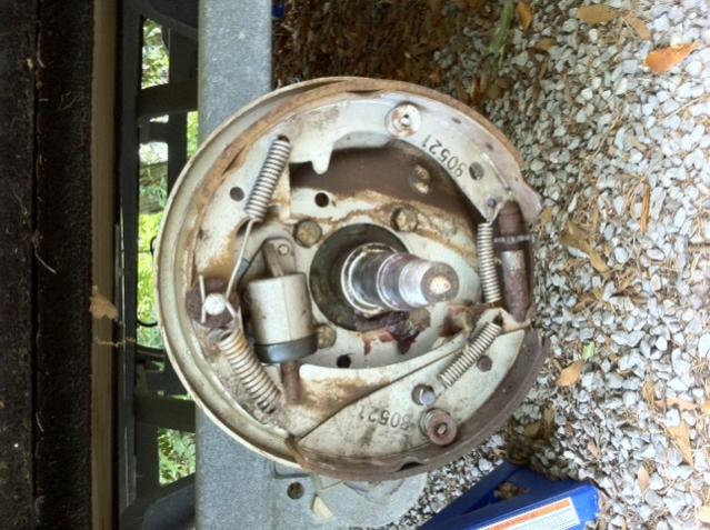

                ram lin told me today i have 1 1/4 spindles, but i have an old email i found saying i have 1 1/16 outer 1 3/8 inner spindle...? also, check this out.Click image for larger version

                  Local trailer shop charges 35$ per drum to turn. Is that a decent price? Notice the dings.
                    That's a rip off i believe. Take it to an auto parts or repair shop.
