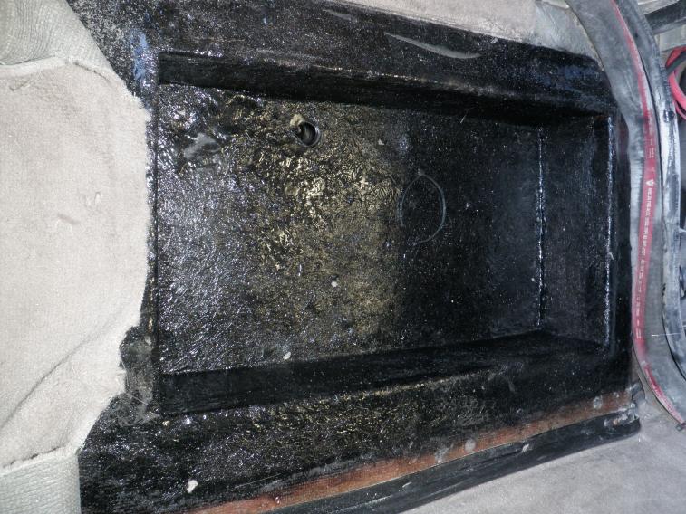

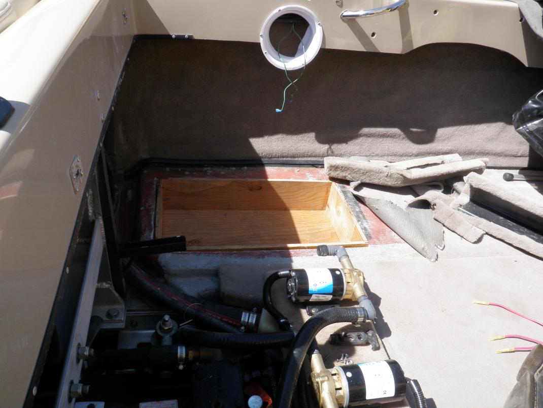

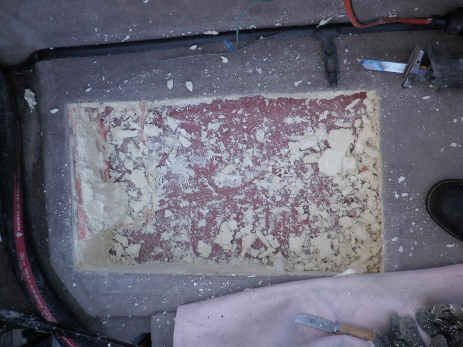

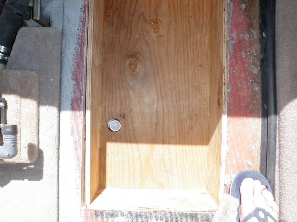

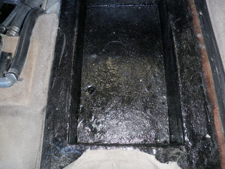

              I have a size 24 and 2 27s without the alternator upgrade and have no problems, that being said, will be probably upgrade at some point (more out of a boredom project instead of necessity). I actually cut into the floor, removed the foam and glassed in a new large battery box with a drain into the bilge area to accommodate three batteries. I should have pictures posted somewhere on my profile I believe. Let me know if you have any questions.

                Here are some pictures of the project, you can see the foam cutout (the second picture), then the wooden support frame, then it being glassed in (with black pigment to match factory)
