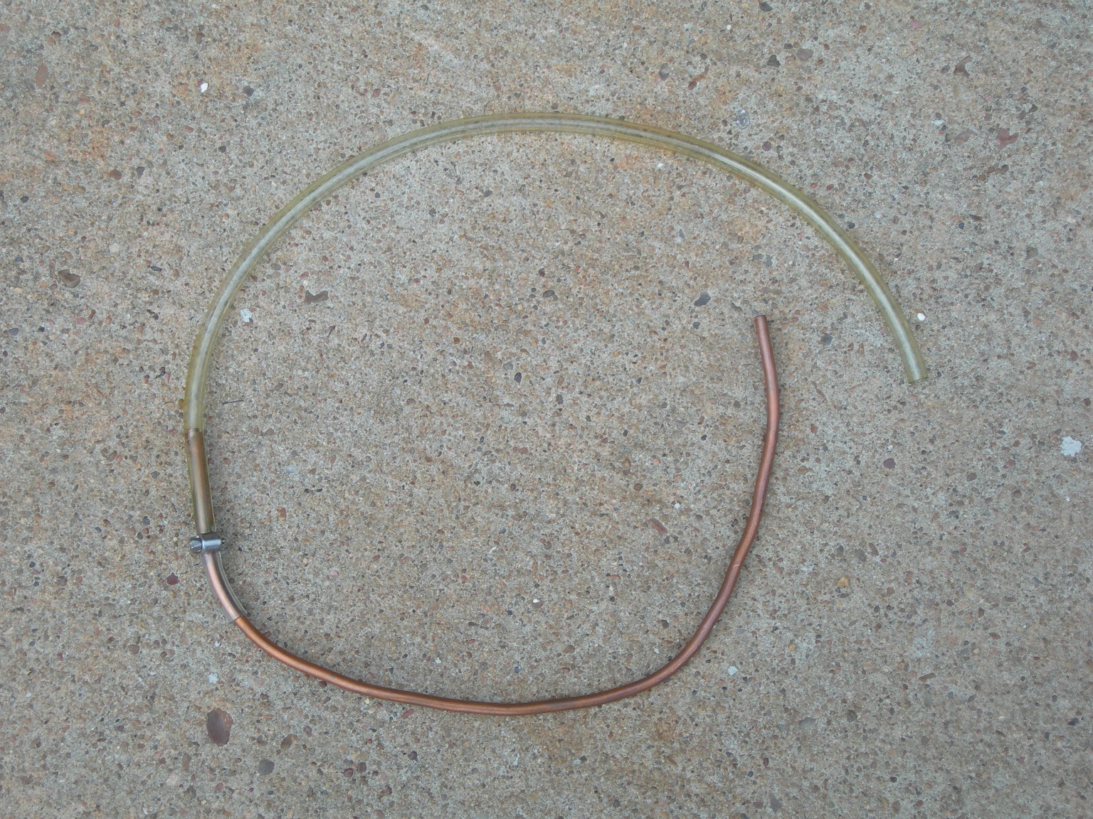

    I'd change oil and filter, trans, and v drive yourself. Impeller is pretty easy too. Do a search on here for impeller change and copper tubing and it'll help. plugs and wires ,etc can be done if you have a few tools. I'd let shop check engine/shaft alignment.

            http://www.planetnautique.com/vb3/sh...-PCM-Excalibur
            I need to put this impeller biz on a stand alone thread and add that there is "TOP" cast into the pump cover. Please be sure to put it back properly. Not sure the triangle works in the other directions....but just in case.

              I changed my impeller in about 30 minutes. You need a 1/4 inch drive with a 6" extension to remove the bolts through the pulley. Make sure you note the direction the pulley turns to replace the impeller in the proper rotation (I didn't and had to back up and have a beer to contemplate which way to rotate it in.) BTW it is a chevy 330 hp. Other than standing on my head for 1/2 and hour, it was a piece of cake.

                  another vote for approximately around 30 mins, standard tools and a couple of beers... just be sure to change the 3 small, and one large O-ring and lube with a silicone base
