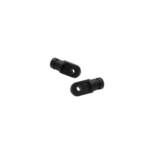

        Yeah they look like this except mine are stainless.
        I need a single crimp ring around the tubing. I'm not sure I understand how channel locks or a vise grip would crime a single ring around the tubing. Can you explain?
