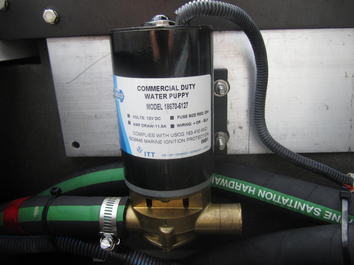

I thought they started using Jabsco's in 2007's. What pumps do you have?the WakeSlayer

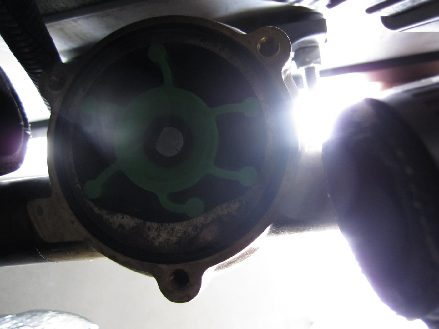

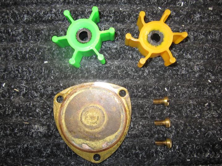

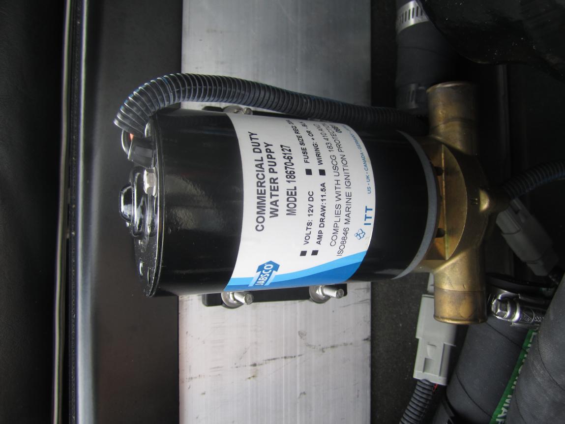

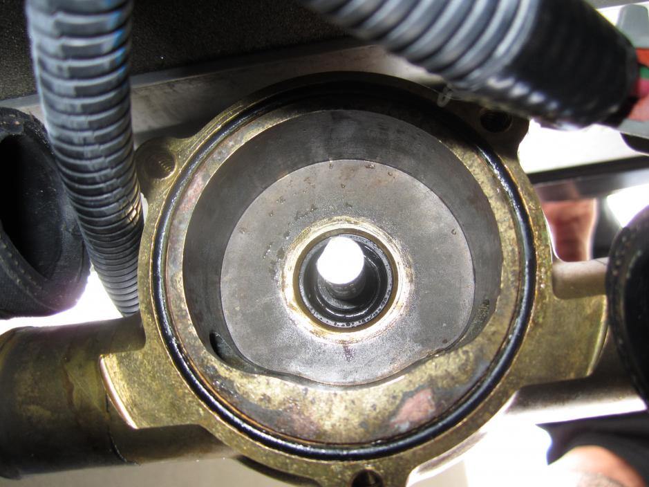

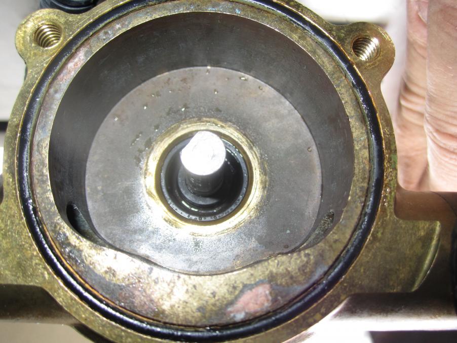

I believe they are Jabsco, if so see the pics below. There are three brass screws that hold the bottom plate on, but be careful not to drop the screws or the large o-ring. Once off, use a paint can top remover or carefully use a flat head screwdriver to pry it off the spindle. One hint is to disconnect the inlets and outlets for all the pumps and move the hoses out of the way, it make things easier to work on. All three of mine were changed in about 30 minsGone - 2008 Air Nautique SV-211 Team Ed - Death by Fire
