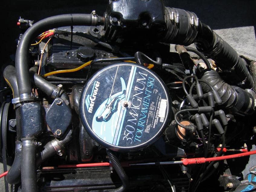

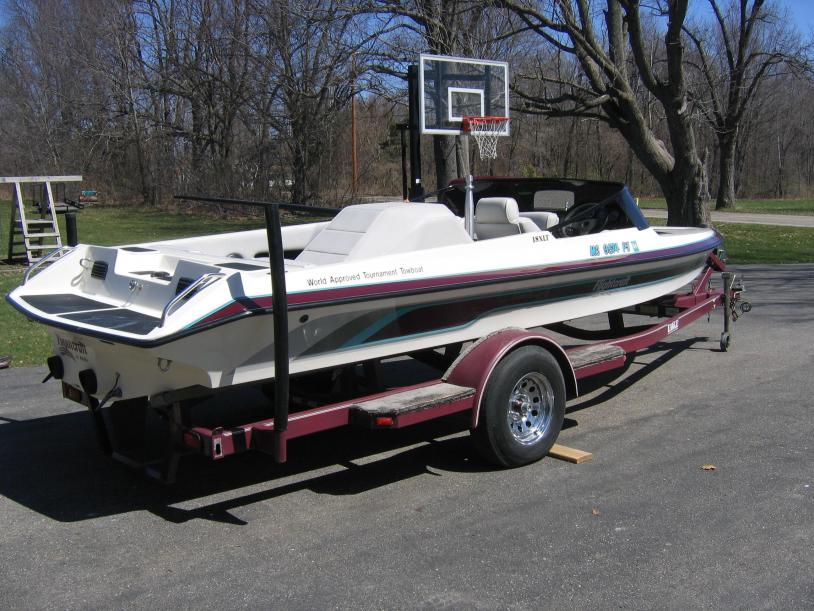

I never post in this section, but here goes. My Flighty last year we had tons of issues keeping it running. At the beginning of the season, we adjust the carb and it ran ok for a day. Next we figured that there was water in the tank because of a poorly place and type of gas cap, so we drained the tank and replaced the fuel filter. We could only find one fuel filter looks like an oil filter up on the motor. Worked for a weekend. Next we found the vent was also place poorly and when water came over the back of the boat when we stopped it would dump down the vent into the fuel tank. Purchased a better chrome vent thing and moved it completely to the side of the boat. Drained and replaced the filter AGAIN. Worked that weekend too. Next we figure out we were buying gas with 10% ethanol which was causing poor performance. Started using Startron fuel additives. Now we are getting 2 or 3 weekends out of a fuel filter. We still think we are getting water in the fuel from sitting all week. At the end of the summer, late Oct we can’t get the boat to idle at all. We can get it to start but I have to manually hold the choke closed with the arrestor off. Once we get it started we have to keep the RPMs at 1.5-2Kish.
Sometimes after we have been out a while it will just stall, Betsey, as we started calling her will eventually go again, but it is on her terms.
We (partner in boat only) and I were thinking we need to buy a new carb, but I thought I would check here first. I will more then likely take it to someone in the spring, couple weeks to look at, but want some ideas. We still might get a new Eddlebrook, there is another Flighty at the marina with a NON standard Eddlebrook that runs 3 MPH faster. P*SS us off. I think we have better low end. I know there is a fine line in the adjustments.
