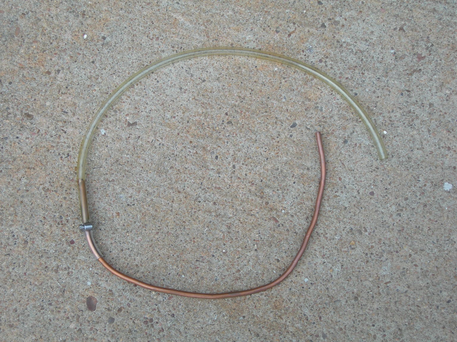

Be sure to make something like this to ensure you don't lose a piece of hose into the gallery as has happened to several on this site.
What size copper tube is that? ThanksRob

Several...and it is costly.Originally posted by crobi2 View PostPeople have had pieces of tubing come off and stay in their transmission? Yikes!
It is 1/4" copper tubing. The hose is 5/16 od x 1/4 id so it slips over the copper. IIRC, the suck up has a 3/8 od x 5/16 id hose...it will slip over the first hose i mentioned. you can use two inch long or so segments of each hose size to step up hose sizes. Avoid bending the copper too much, it will kink and/or break.
Thanks! I did'nt see your reply yesterday in time and went ahead and siphoned a quart out using my old 12' long 1/4" id tube and shopvac to start the siphon. I did a quart last December when we got the boat and after reading this thread did another quart. Probably doing this once or twice a year is not a bad thing.Originally posted by AirTool View PostSeveral...and it is costly.
Do the ends of the vinyl tubing just get brittle and break off or do people lose short segments of hose down into the transmission?
