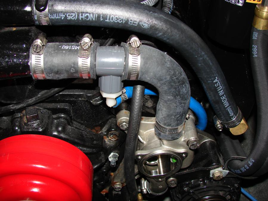

On my direct drive Excal the drain hose (about 3/4"dia) runs from the oil pan drain hole and is fished up the front of my motor adjacent to the Raw water pump (impeller) then across the manifold to which the end cap is clipped. The end of the hose is a brass fitting with a brass cap. This is how it was installed at the factory, also keep in mind your motor is rearward and rotated 180deg different then mine.
Ideally you want to warm the engine/oil prior to draining, I use my suk-up pump on the dipstick then on the drain hose through the hull, feel this removes as much of the old oil as possible.
remove the plastic shroud on the top of the engine, and you'll see it clasped with a shower curtain ring (if the dealer was changing the oil previously) as this is where the stow it from the factory. Like Chris said, it has a brass nut and is connected to the bottom of the oil pan.'08 196LE (previous)
