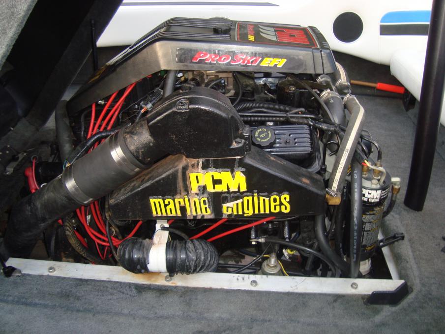

                              • ToFastToCare
                                • Sep 2010
                                • 22
                                #30

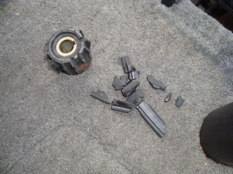

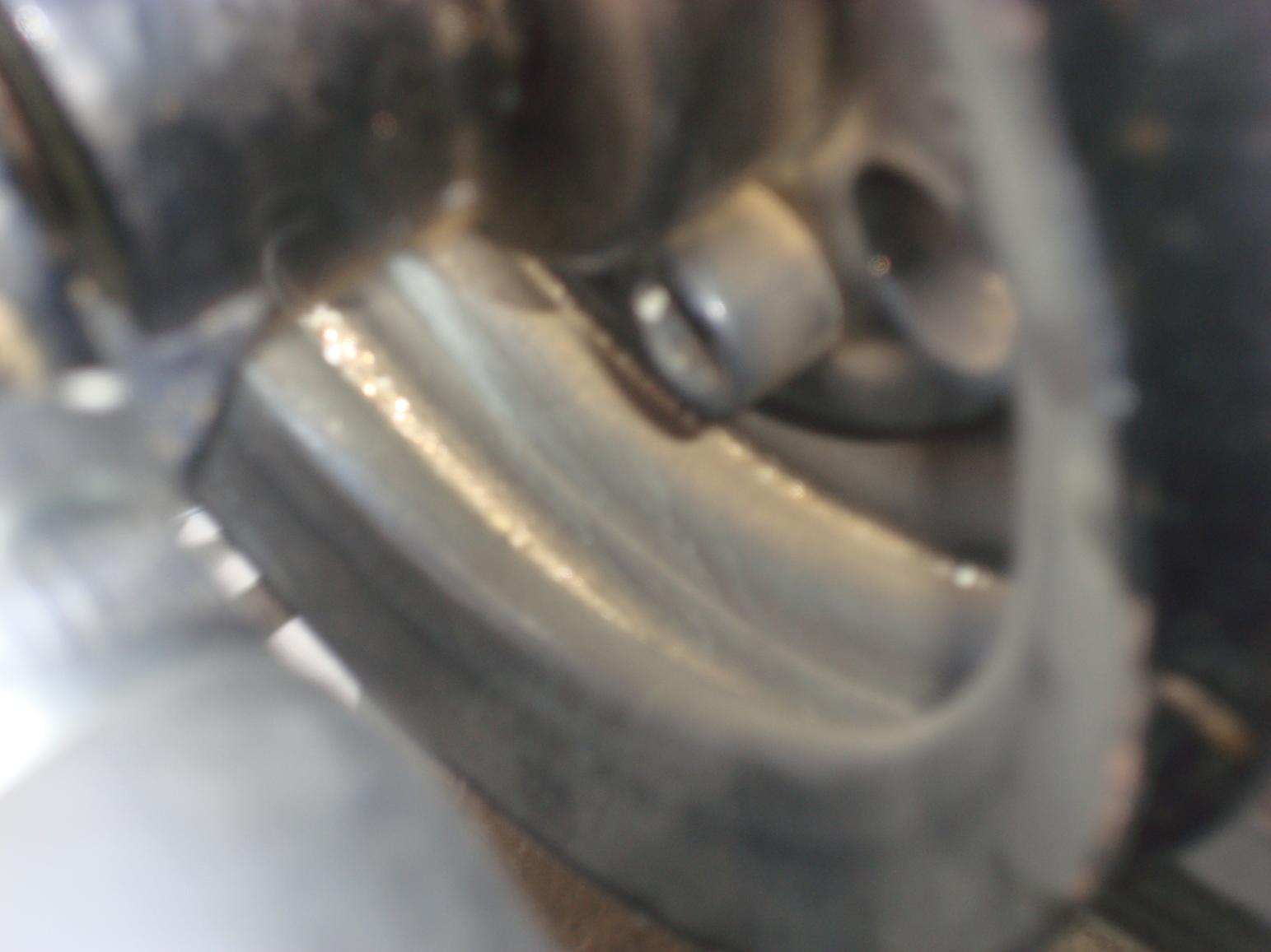

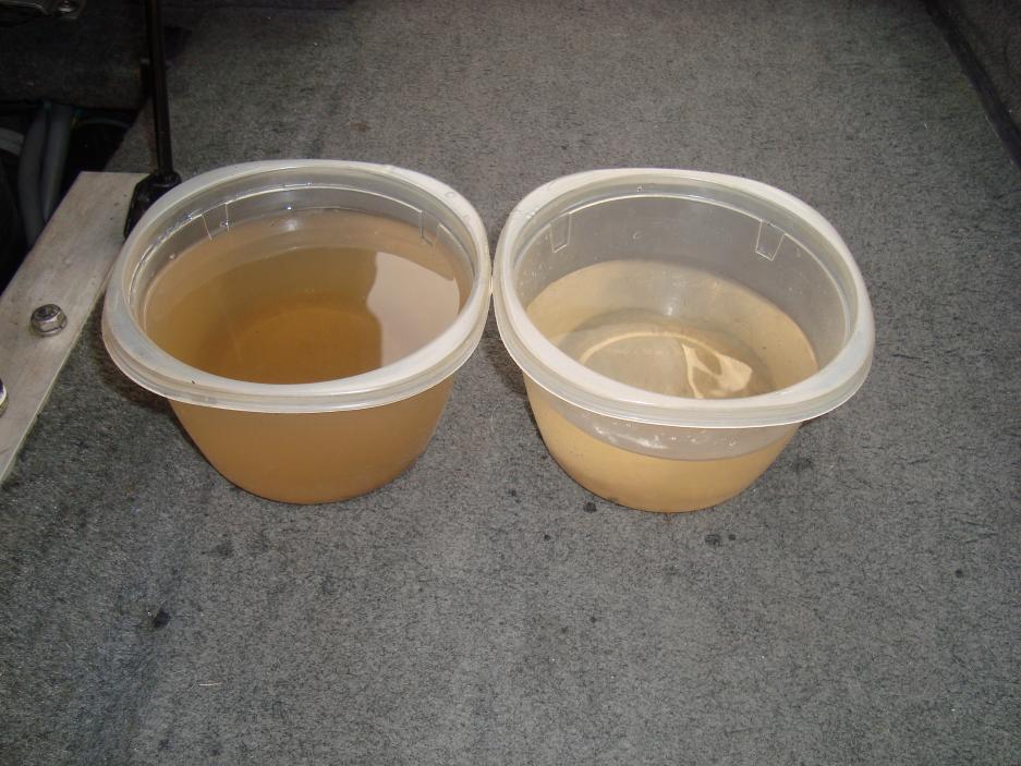

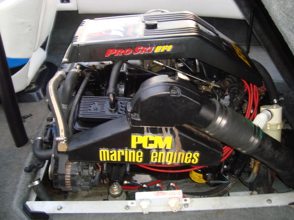

                                I am going to try to get it started this week. Need to get some oil and a filter first. Here are some pics of the boat and what I have found so far.
