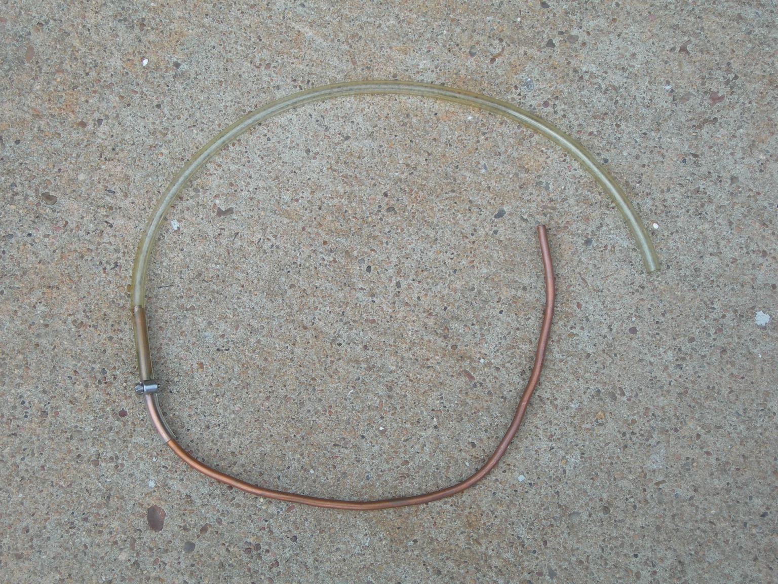

    My 2nd question is in regards to changing the transmission fluid. On my 1990 SN I was able to use a transfer pump that had a about a 1/2 inch tube attached, it worked great. On my 2005 I don't see how my transfer pump will pull anything out of the transmission. The fluid registers correctly on the dipstick but I can't actually see the fluid. Do I need to get a transfer pump with a very thin extractor tube?

    For the second question, you need to build one of these:
    search my posts for more about it and tranny fluid changes.

      Thanks AirTool. Just made one with stuff I had in the garage!
