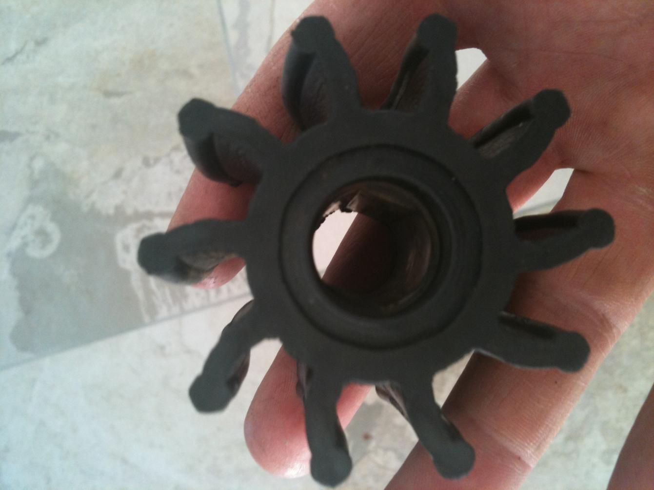

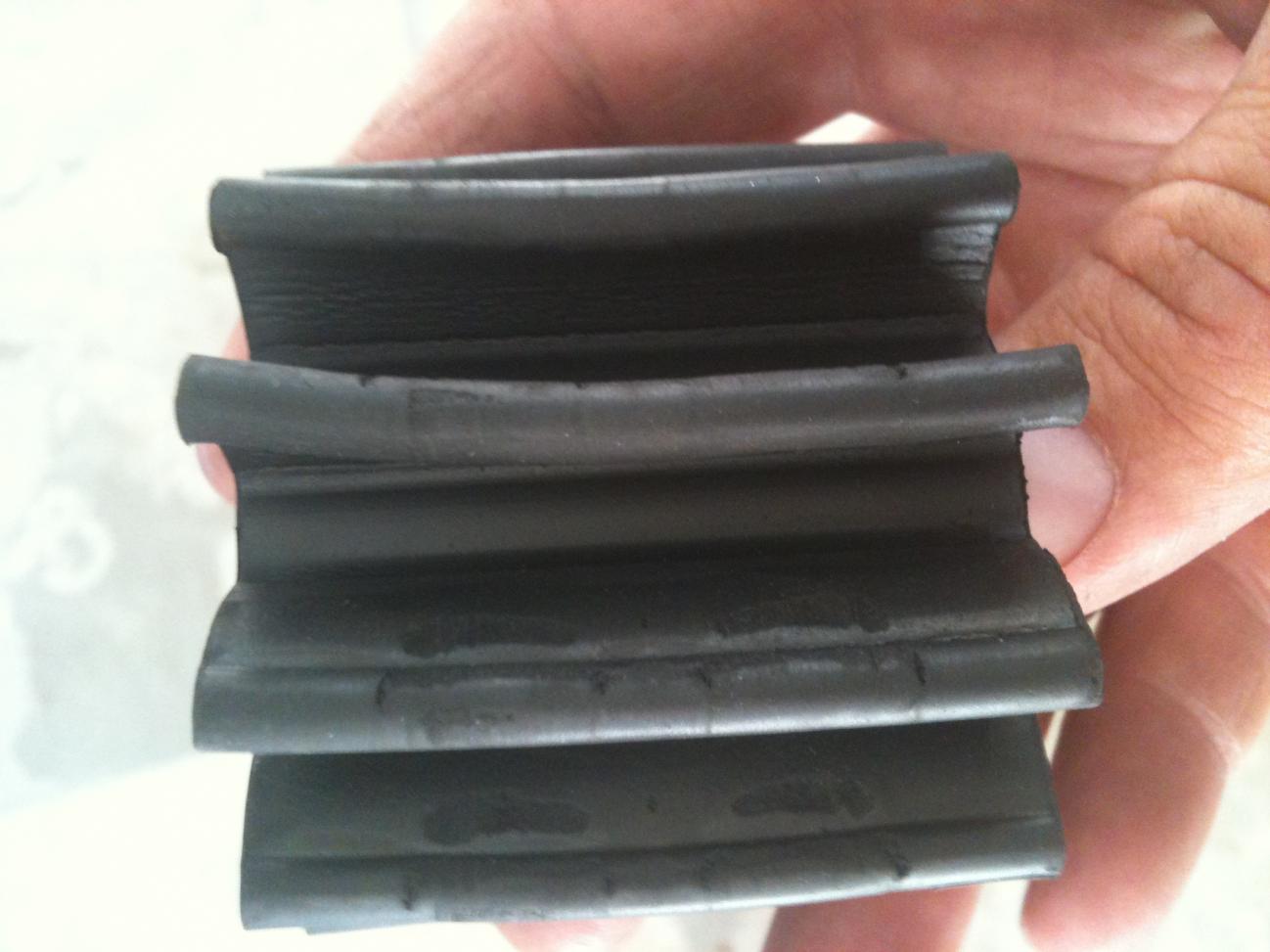

            Fixed??
            OK got impeller changed out, also checked the strainer backet elbows and found they were very loose. taped them up and reattached them. Also checked all the hoses for air leaks etc. Had a little water on manifolds so i nipped them down a bit tighter. Other than that its a water test later to see what happens next!!!

                NicksNautique's, that impeller doesn't look that bad and shouldn't have given you an overheat alarm. I think you may have found the problem with the elbows. Any air leak on the suction side will mess things up.
