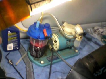

          This is what I use to remove my transmission oil.
          It is an old medical vacuum pump.
