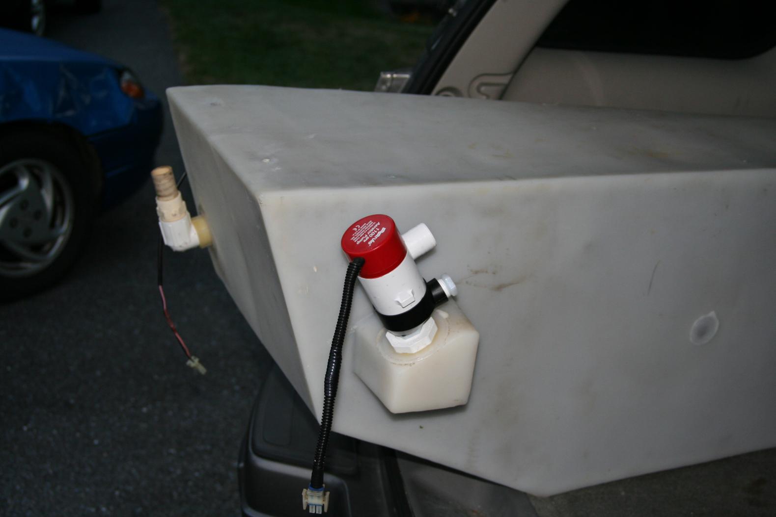

Just found this post. Does anyone know the part number for the Rule pump and best place to buy? There are a lot of options on pump models and would like to have it before I start the project so it screws into tank.
Thanks for the help.If it aint broke, don\'t break it, and if you can\'t buy it, built it.
www.hsetrident.com
Here is the replacement pump from NautiqueParts that I used. I suggest reading though the note, and the link back to Planet Nautique, as this replacement pump is not the original part, they say original part is no longer avaliable. It's working well for me.
Edit: Here is the link for my post on installing the new pumpLast edited by Beach-TJ; 07-11-2013, 04:22 PM.
Hi TJ, thanks for posting and your forum regarding the 90 degree fitting, nice knowing that going into it!!If it aint broke, don\'t break it, and if you can\'t buy it, built it.
www.hsetrident.com
Did the pump change last night and I did not use the 90 degree fitting. I installed the pump and used the 90 degree outlet fitting supplied with the pump for the hose going to the drain port on the side of the boat. The pump was longer than original but I was able to slide tank over to allow it to fit into the cavity in the floor and just installed the brackets screwed to the floor about 1" toward the side of the boat from their original location. Now just wishing the wind would die down to get back on the water.If it aint broke, don\'t break it, and if you can\'t buy it, built it.
