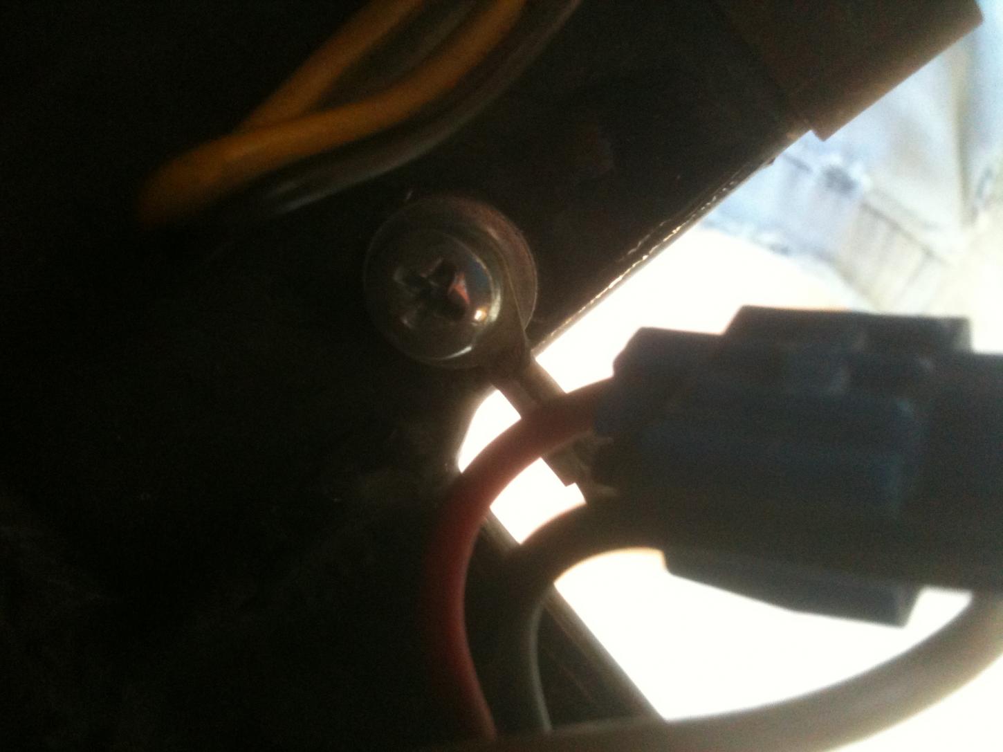

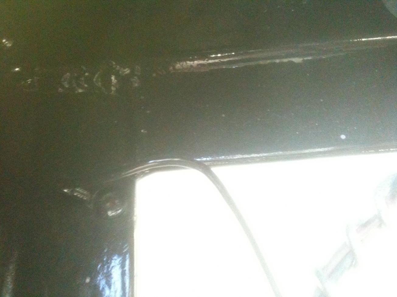

      Check the grounds, too. Chances are, if you have a fuse out in the tow vehicle it could be caused by a short on the trailer. Using a test light to trace where the power is flowing helps as well. My 02 DHM trailer had a similar problem that was caused by a bad ground where the negative wire was riveted to the trailer frame. I drilled out the rivet, cleaned up the metal underneath, and bolted it back in with a screw and nylock nut. Good as new.

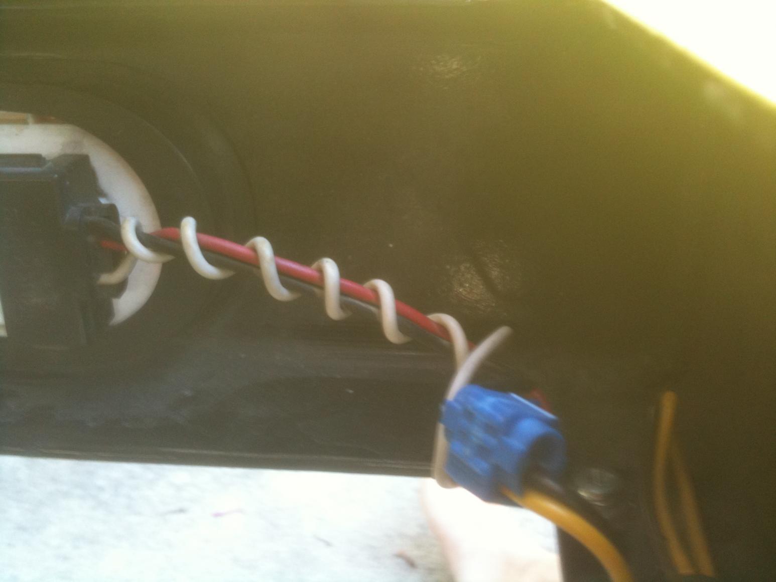

          Shane, here are the pics I PM'ed you about:
