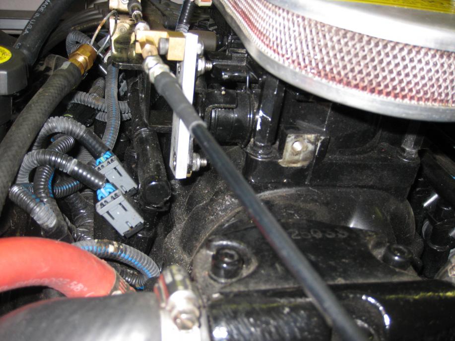

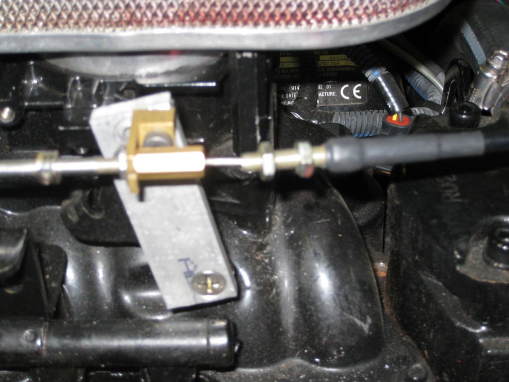

    I have a 2004 SANTE 210 with wakeboard pro perfect pass. I believe there is a bracket missing where the servo cable and the throttle cable connect(See Pics). It seems pretty obvious to me that something is missing. Could somebody post a picture of that location and a picture of the entire set up (servo motor, servo cable etc).And if there is supposed to be a bracket do you happen to know where I can get one? Called perfect pass and they dont carry them. Thanks

    I may be wring, but I belive that brass hex needs to be to the left of the brass 'L' and the two silver nuts should sandwich the silver threaded PP housing onto the 'L' bracket.
    This allows PP to "play" out cable and reduce the throttle position after it engages.

      Nothing missing. Attached incorrectly.
      The two 10mm nuts on the servo cable sandwich the brass chair on the throttle arm, the large 10-32 brass connector connects to the end of the control cable to the servo cable.

        Wow Duh, thanks for the help. Solved my problem.

          make sure not to overtighten the L bracket to the throttle body arm thing, it will not swivel and your linkage will bind causing extreme wear on the throttle cable itself, as in kinking the cable and rubbing through it
