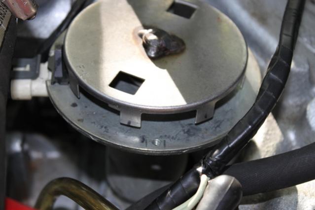

                    Here is a pic

                          Regardless of what our resident "expert", bobchris, says..........if you have pulled the "distributor" you want to get it back in and one of the tangs pointed at the pickup on the correct stroke. If you just put the engine at tdc on the timing pointer you only have a 50% chance of being on the correct stroke. That was the reason on pulling the valve covers to look at the rockers. You can also sight into the spark plug hole for the piston to reach tdc, or you can put your finger over the hole until it puffs out. Or you can use a degree wheel and piston stop. Regardless of what method you use to find TDC of one, you have to do it. Otherwise it's a crapshoot to get it started.

                            The "Device" to me seems like I can loosen it up, plug my timing light and turn the engine over and see where it lands on 10. If its off, turn the "device" to get it close to where it needs to be. Turn the engine over again until I get the light lined up with the 10 mark.
                              Yes, essentially. Not that hard once you do it once. The body of the "device" or distributor as you intially called it has a pickup in it that senses those tabs flying by it. Once you lock it in so that the tabs fly by at the right place, then the protec advances or retards the timing for you.
