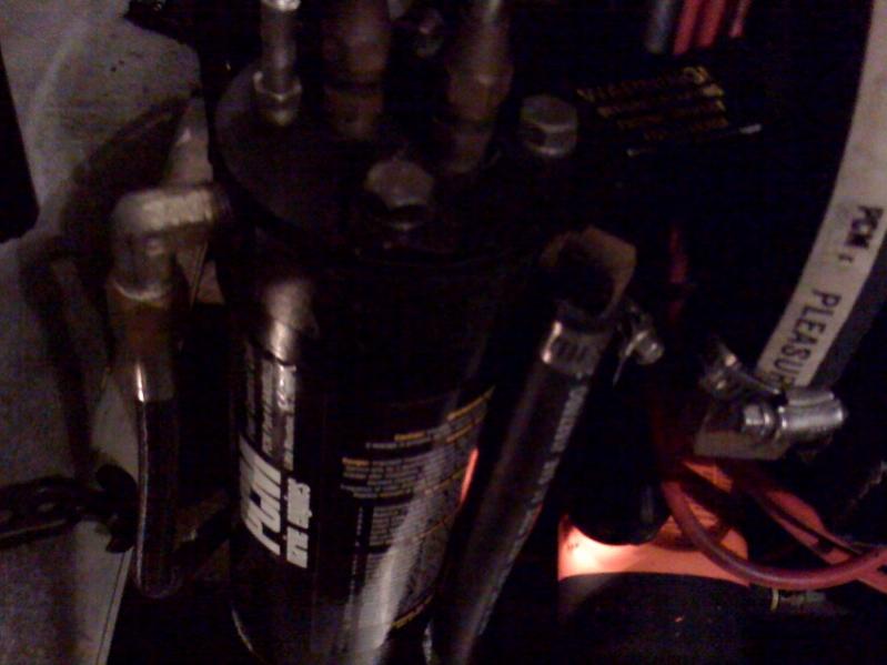

Thank you so much for your reply. A wealth of info! To clarify things for me, the low pressure pump is responsible for sending the fuel back to the tank during idling. This is through the LARGER hose on the top of the FCC. I have attached a pic to be sure.
My stupid question is that is the LP pump is dong its job of supplying gas to the FCC, (since I never have any issues while the boat is in gear), then it might be reasonable to believe the issue might be a clogged line back to the tank? Or does the pump require more psi to pump the gas back to the tank during idling, and the pump has weakened?
