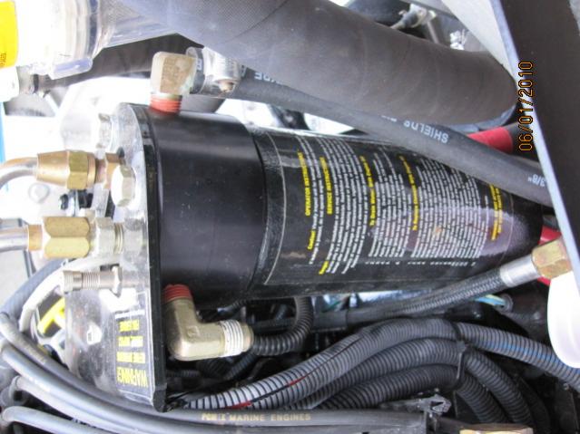

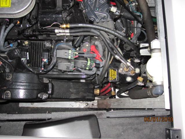

      The first picture you attached is the low-pressure pump. The larger hose with the hose clamp at the bottom of the pic is the fuel supply from the tank. The smaller braided hose at the top of the pic is the supply line going from the low-pressure pump to the FCC. In your picture of the FCC, the hose you have removed is the line coming from the low-pressure pump to the FCC. The large hose with the hose clamp is the fuel return line going back to the tank. The 2 lines on top of the FCC leading to the fuel rails on top of the engine are the supply and return lines to the engine. The larger line being the supply and the smaller being the return.
      The low-pressure pump pulls fuel from the tank and feeds it to the FCC. This is because high volume/high-pressure pumps do not pull well and since there is no good way for gravity the feed the FCC given it's mounting location the low-pressure pump is the best alternative. Once the fuel is in the FCC the high-pressure pump boosts the volume and pressure to adequate amounts to feed the engine. Any remaining fuel is returned through the fuel pressure regulator and back the the FCC where it will either go back the the tank via the return line or be recirculated back through the engine again.
      You will have an electrical connection at both pumps. I don't know for certain, but I would assume you should have 12 VDC at those connections when the ignition is first turned on and the pumps cycle. Now also assuming you have proper voltage at the pumps, then I could assume your pump may be bad. The louder of the two pumps should be the one in the FCC (high-pressure pump). This would be the one you would hear where the ignition is cycled. I doubt both your pumps have gone bad at the same time, but I have seen stranger things happen.
