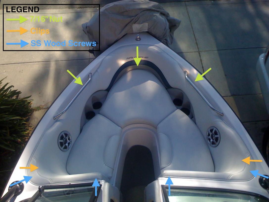

I'm trying to remove the backrest for the bow seating in my 03 SAN for cleaning and speaker replacement.
I did some research here on the process before attempting removal last night. I though I had it worked out, but seems not.?

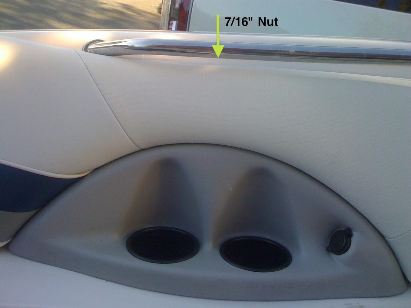

So far I have removed 2 x screws on the port side under the windscreen area, another 2 x screws in front of the driver, and 1 double nut arrangement at the front. I have felt around as much as I can reach behind the cup holders but there are no fixings here (except for the grab rail).
I understand that you have to lift it at the cabin end to pop it out of the locating clips.? I lifted it as much as I dared last night but it wouldn't budge.?
I don't think I missed any screws, but I will double check - it's pretty busy with wires, ducts, and the subwoofer behind the drivers kick pannel.
Thoughts.?
