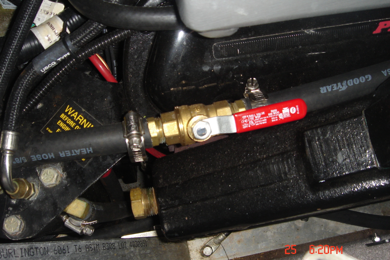

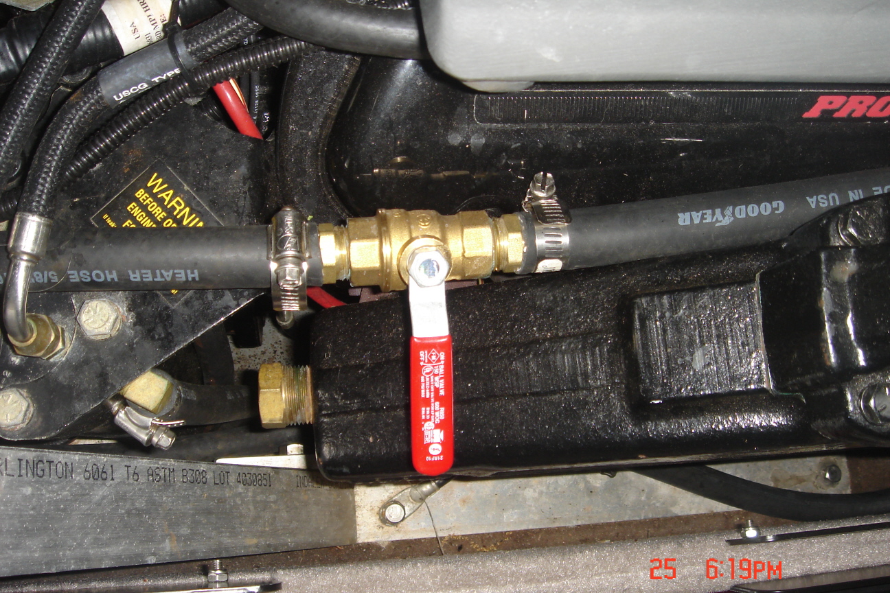

            Another option is too install shutoff valves into the two hoses that feed the heater. I installed shut offs in mine so I don't cycle hot water through it in the summer in hopes of preserving it's life, and so I can shut off the water flow if the core does go south. This way you cam stop the leaking and then fix the heater core when your ready. I got the valves and clamps from Lowe's for $10.00. I can post a picture if that will help.

                  Here you are...
                  JMO

                      There are two, but it's not easy to get a clear picture of both in the same picture. I have a vdrive, so I put the shut offs near where the hoses connect to the block since I can easily reach them by opening the engine hatch. To access the heater core I would have to unscrew the kick plate underneath the dash.
