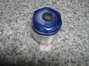

was fixin to move my boat to my new house when i saw the little clear kodiak piece laying on the ground. my question to ya'll is: should i order just the plastic or the plastic and metal collar; any instructions on installing the collar if need be? btw, i hate my life!
boat is currently still at old address. i was over there moving some stuff and decided to give it a go and got it off. the new one came in so tomorrow i'm going to get some grease from west marine and put the new one on and give the boat a little test drive around the neighborhood. i have a 300 mile trip to the dealer that NEEDS to be done. don't want this problem on the road so hopefully the other 3 are in good shape.
The caps with "fill to hole" are originally intended to be used with fluid. Your bearings use grease so disregard the "fill to hole", just grease your bearings as usual.Originally posted by hourglass View Postthe clear threaded cap says "fill to hole." does that mean put grease in to cover just over the hole? do i need to grease the collar after it is installed?2013 SAN 230

there is grease in there like crazy still. and the cap was full when i picked up in the drive way. should i just put the collar on then?. thanks for the help. eventually i am going to upgrade to discs brakes and replace all my bearings, but lacking the funds right now.
Stick your finger near the middle of the spindle to see if you have a grease fitting.Originally posted by hourglass View Postthere is grease in there like crazy still. and the cap was full when i picked up in the drive way. should i just put the collar on then?. thanks for the help. eventually i am going to upgrade to discs brakes and replace all my bearings, but lacking the funds right now.
If you have the fitting ....
(The risk here is you have a weak seal on the back and you pump grease into the brake drum and have to take it apart before your trip.)
Otherwise, jack up one wheel and pump grease into the fitting while you spin the wheel. Catch the grease that comes out the front (carefully) with paper towels. Have a helper...and before you start, line a small trash can with a plastic bag to keep nearby. Also wear rubber gloves....this can get messy. Just spin, pump, spin, wipe, etc. In the past, I've used a different color grease that the last time so I can see when the new grease shows up. Start with a full gun, each hub will hold almost an entire tube the first time (if just the bearings were packed by hand and the hub wasn't filled) and then about a half a tube thereafter.
thanks air tool. you're always a source of knowledge about infinite subjects. if i had a dealer w/in an hour i'd be less pissed, but it's always something with anything i own, but since it's a boat it's even more of a pain. someone buy it please. refer to classifieds. im just going to tap on the new collar and cap, add grease, check lugs and test drive. i don't have time to put up with this. it's one little thing after another. and it's always a little thing that inhibits use for me. after i get it fixed and the trailer in working order i'm sending this thing to the grave yard.Last edited by hourglass; 05-16-2010, 12:04 AM.
That was the original intent and now they (kodiak) recommend grease for boat trailers.Originally posted by ffmedic74 View PostThat type of ramlin wheel bearing takes 90w or 80w gear oil not grease! They only used them for 2 years, had issues with them, and switched back to grease type hubs.
The trailer mfg's ship with grease. It is a pretty good design since it allows access to the spindle fitting. If you don't have a spindle fitting, then use a spring loaded bearing buddy instead.
