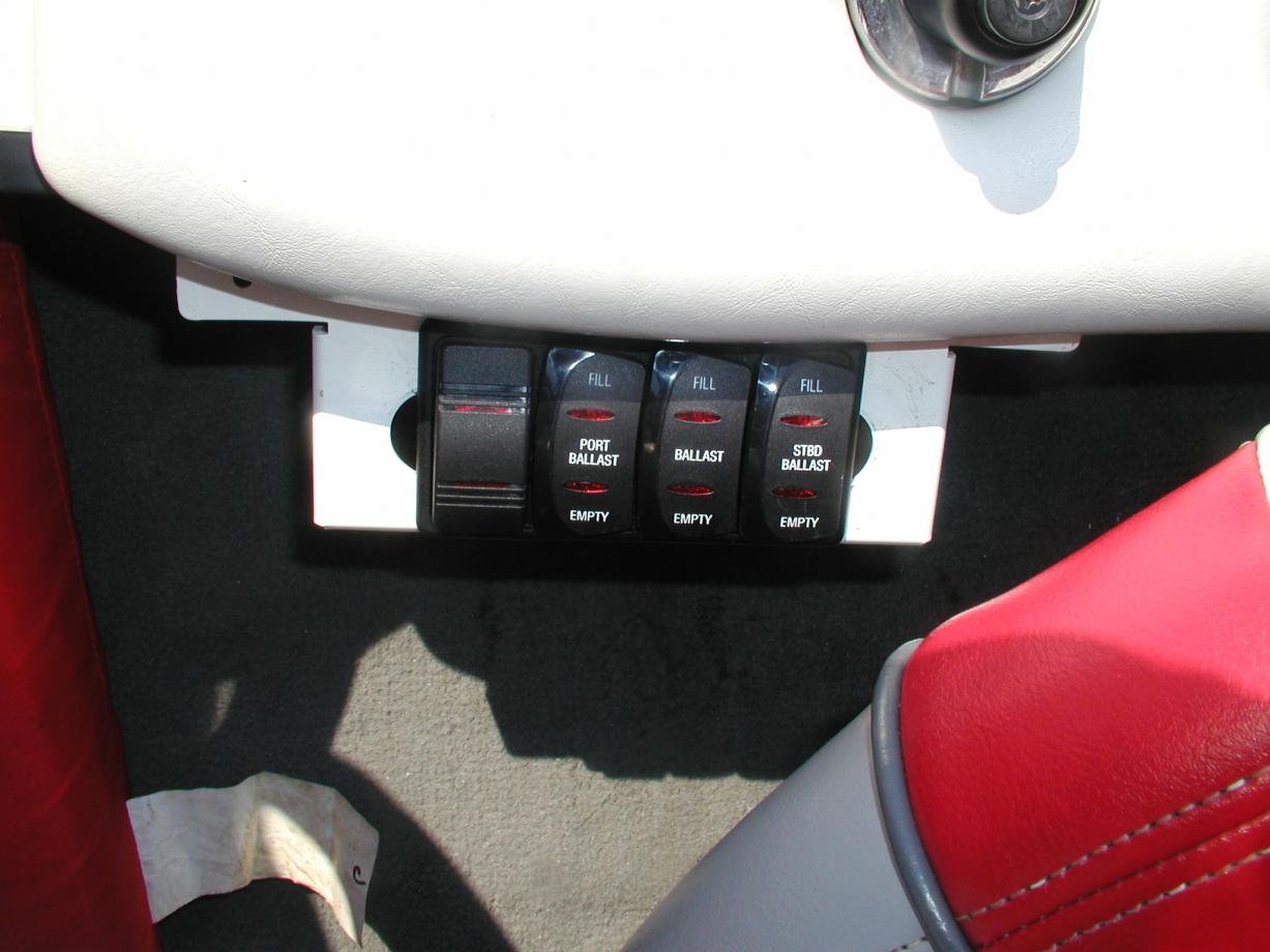

              I think I have a couple of pics of the switches, my boat being a '99, the dash/side consoles are different. I used lighted rockers on my setup. I'm thinking about redoing it with some new switch gear, my switches currently work fine, but they are not in the best location, they are thigh level on the driver's side, under the throttle, so it's possible to hit them with your leg inadvertly. Not really sure where else I can put them, so I'm still thinking about it...I need four switches for my setup, 1 for the RV gate, 1 each for the fill/empty pumps for each bag.

                pic of switches, as I mentioned, functional, but...
