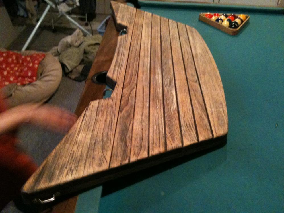

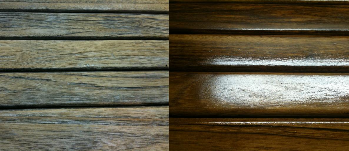

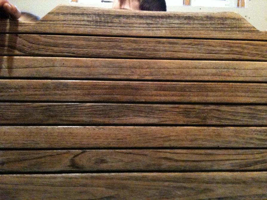

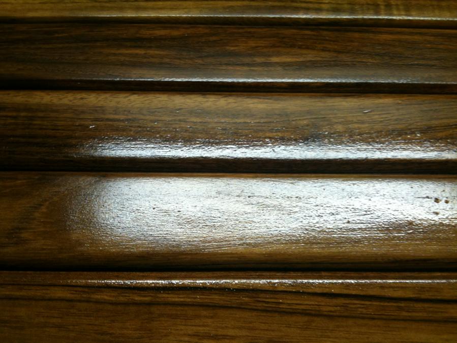

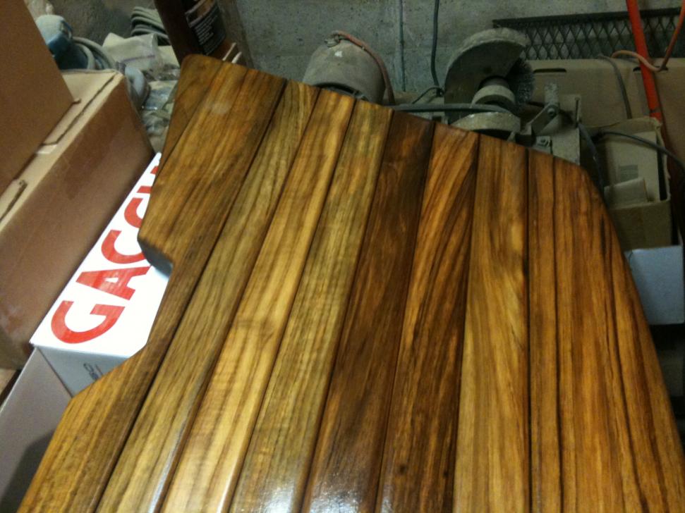

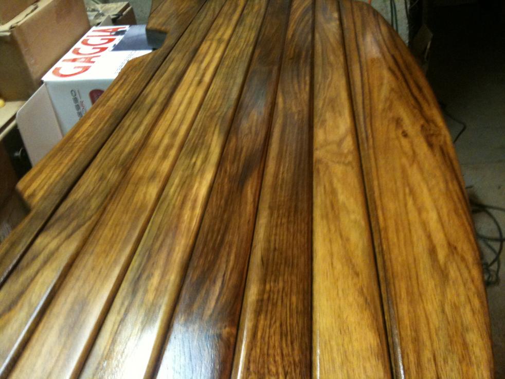

    I have seen many discussions on the best way to refinish your teak platform. I have a 2002 SANTE and got a beautiful finish on my platform. Here is what I did
    1) Sanded the platform starting with 80 grit and went all the way to 160 Grit right down to bare wood making sure i got all the grey out of the grain of the wood
    2) shop vacuumed all the dust out of all the cracks
    3) Applied starbright golden teak oil (8 Coats). I brushed on the oil for each coat and let it sit for 15 minutes before wiping it down with a rag. I waited 24 hours between coats. (I dont believe in using the teak cleaner, if you have the time nothing works better than sanding down to the natural wood).
    Below are some pics.

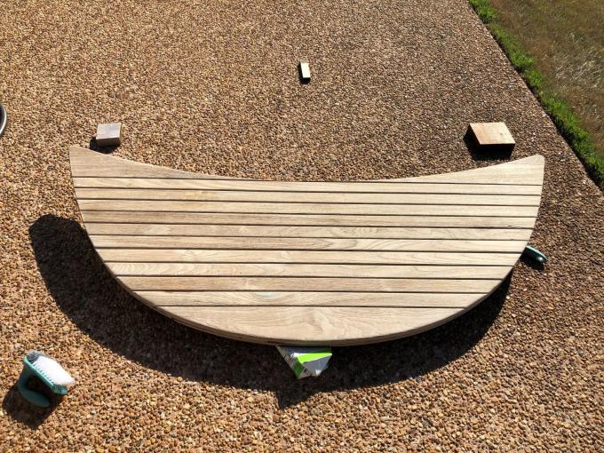

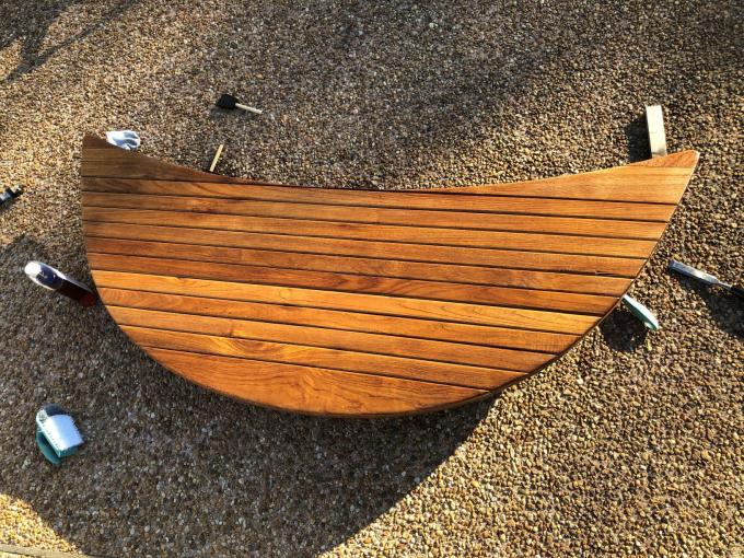

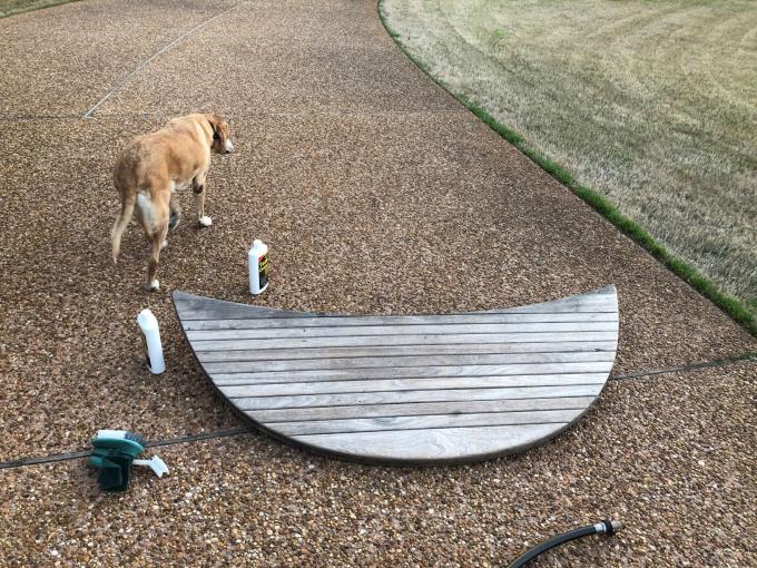

            I'm resurrecting an old post here, but thought I would share my first attempt at refinishing my teak platform. My platform was in pretty good shape, so I elected to forego the sanding and rather did the three-step starbrite application. I spent a lot of time on the first step of cleaning and was surprised by how much "tarnish" came off. Here are the results of each step and the final result after only two coats. I plan to apply more as the wood absorbs the oil over the next few days, but here is what it looks like so far.
            I have photos showing:
            1.) before the restore
            2.) after applying the cleaner and scrubbing with a nylon brush
            3.) after applying the brightener
            4.) after 2 coats of oil
