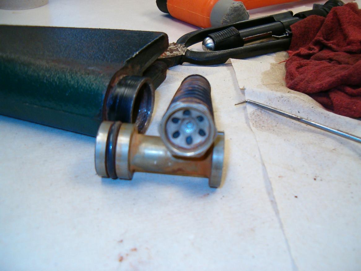

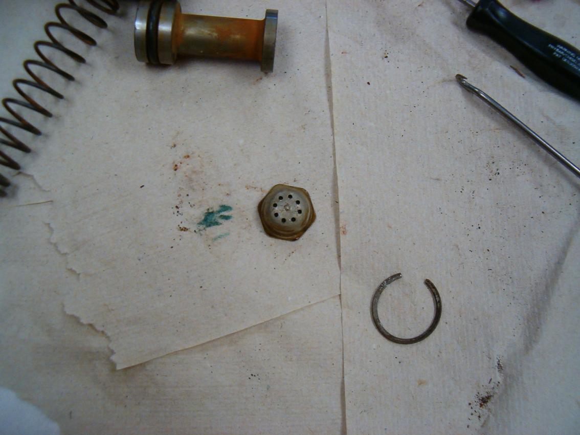

      That brake kit will work, but you can get much cheaper kits from other places. I think Trailers by Dorsey has disc brake conversion kits ready to go for under $250. They are tie down. I got my Kodiak kit from Champion Trailers in Slidell for under $300. Those kits also come with lines, which you will need for disc brakes as the calipers float in those Kodiak kits.
      For the orifice, you don't need to replace it, you need to remove it. Here is a picture of it.

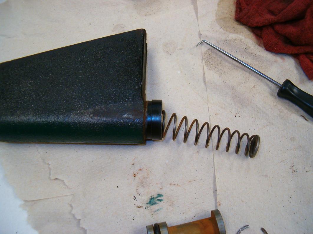

                        I had a question about reassembly so I am posting this picture here. Note the spring direction.

                          Got the master cylinder back together, flushed, and bled. I was going to adjust the drums and found that the left bearings sound shot. I replaced the hub on that side last summer and I think they gave me the wrong seal. There was grease everywhere. Now I need to find the bearings and seals somewhere tomorrow.
