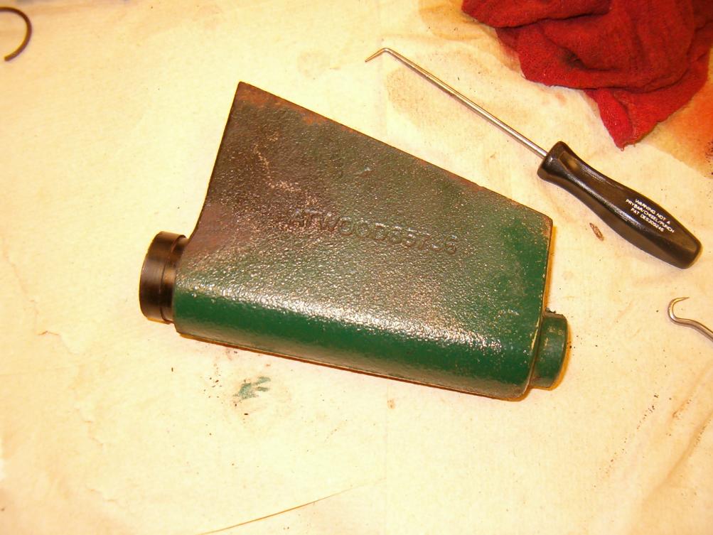

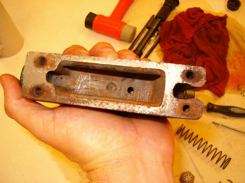

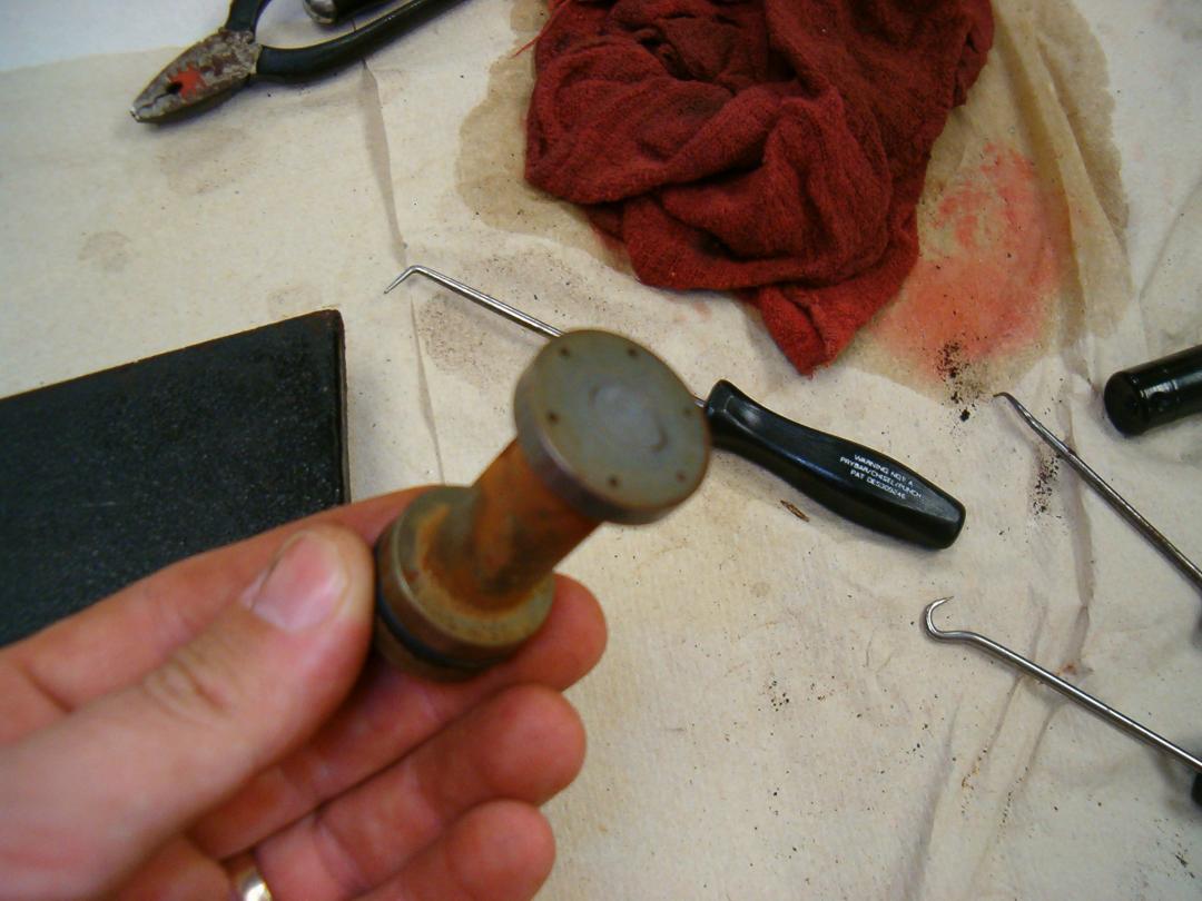

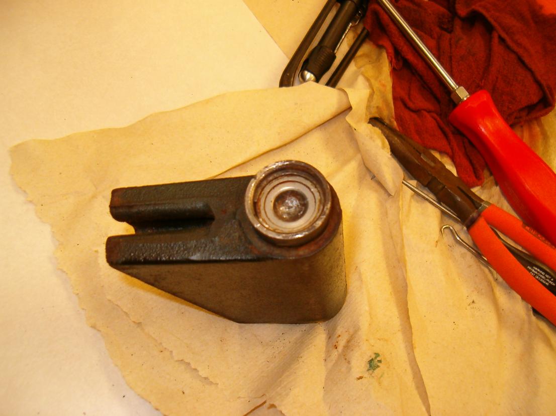

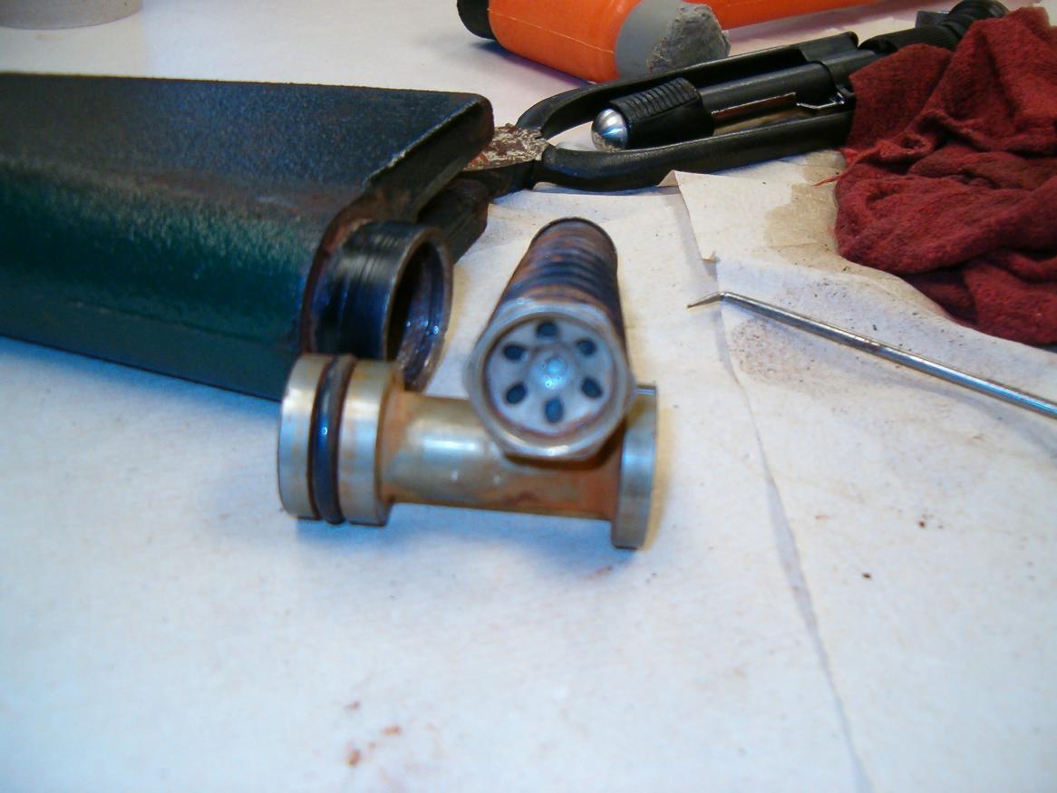

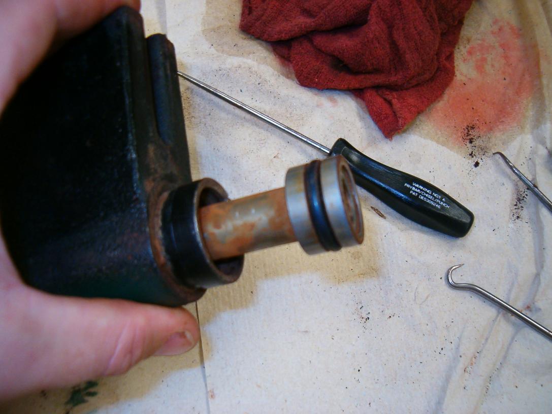

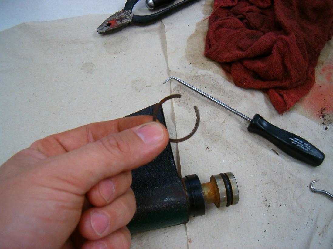

                    Depending on the actuator, the master cylinders are very simple. You can piece together a "rebuild kit" by going to the hardware store. There aren't many parts at all. I rebuilt one that I thought was hopeless. It was full of rust. Works fine now. I converted it over to a disc brakes. Here are some pics.
                        Good idea, I can save $120. What all did you need from the hardware store?

                        • steve-o
                          • Jul 2009
                          • 231
                          Suprisingly not much. Just a couple of o-rings and e-clips. Everything else was in great shape.
                            What did you use for the gasket? My reservoir seems pretty bad. The actual cylinder seems alright. I have been cleaning it with PB blaster, brake parts cleaner, and now rust resolver. How did you end up getting all the rust off?
                            Previous:
                            2011 Super Air Nautique 210
                            1994 Sport Nautique
                            • steve-o
                              • Jul 2009
                              • 231
                              Are you talking about the main gasket for the reservoir cap? I used RTV for gaskets.
