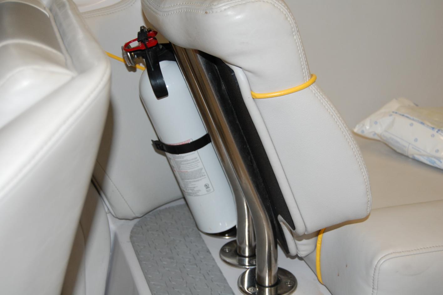

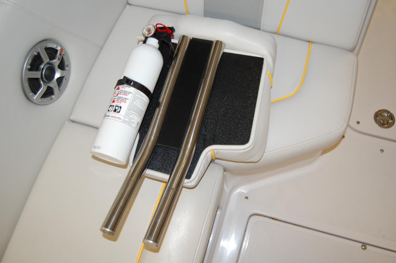

                          Can't help you on your heater problem but I have a couple pics of my fire extinguisher install. I mounted mine on the seat lean back behind the drivers seat. The only thing is you end up losing one cup holder but that cup holder is hard to access anyway in my opinion. It is very accessible for the driver or passengers with it being mounted there.

                            Thanks Latonkaborder that is the kind of idea I am looking for creative and easily accessible.Does it get in the way when you spin the drivers seat.I might have to steal your idea hope you don't mind.
