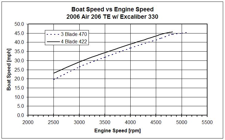

        Correct. Wash is worse on the 470. Pull is softer. Get up and top speed are basically the same. See chart.
        Here are the only props available from ACME with the proper diameter/shaft/rotation. Your only real choice for more low end is 654 but might over rev high end. 1606, 1604, 1210 are clearly pitched too low IMO.
          The RPM vs. speed chart is fine and dandy, but it doesnt tell us much in regards to performance. Of course the 470 will turn a few more revs than the 422 at any given speed... it has 1/2" less pitch. For the same reason, it comes out of the hole faster, not softer. Ive measured this on multiple boats. Ive seen a consistent 1/2-1mph increase in top speed as well.

            For the same reason, it (470) comes out of the hole faster, not softer. Ive measured this on multiple boats.
            I didn't have a good way to measure the hole shot. I did change from one prop to the other on the same trip and noticed a bit more bow rise with the 470 so that might indicate a hair more low end thrust. The three blade made driving the boat easier but didn't have the bite of the 4-blade when powering out of a sharp turn.
